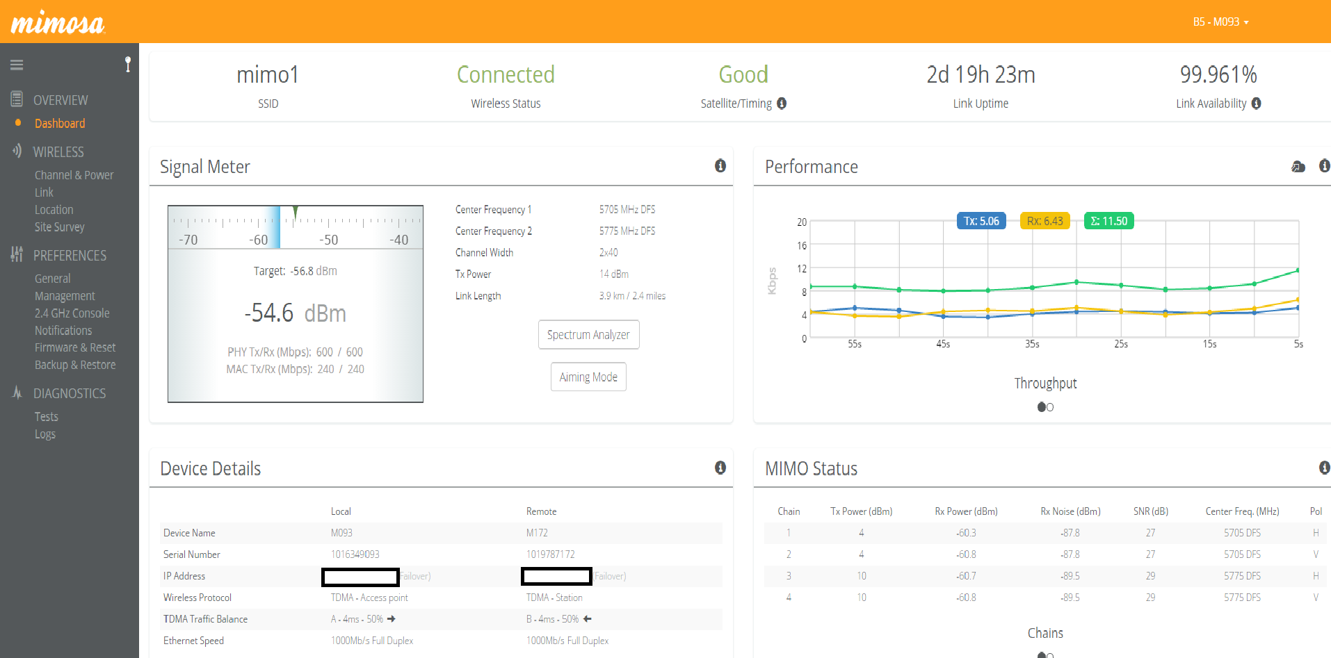

Colocated 2 mimosa B5 at one site with 2x40 Mhz Channels. Channel in upper Band is shared. One link uses a second channel in the upper band the other uses the 2. channel in the lower band. ETSI allows 36db EIRP in the upper band and 30db in the lower. Lower band has more channels so we use the lower band where possible at lower distances to keep the upper band free. At longer distances the lower band has low tx-power.
Having 2 channels available gives a lot more options. GPS sync works great. Aiming with the Smartphone using the builtin 2,4GHz AP is great.
Doing 240/240 in the middle of a city as backuplink between 2 licensed fed sites.
Love this B5s and ordered some more links.

- Attachments
- mimosa.png (160.32 KiB) Viewed 8416 times
