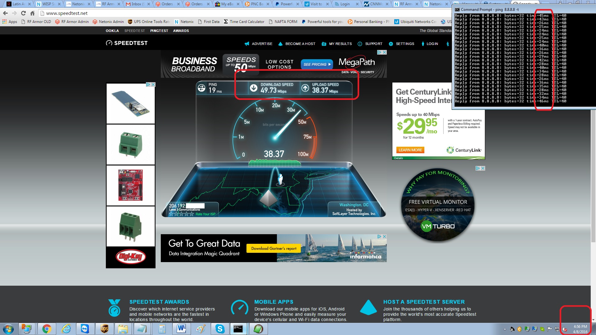

Normal speeds
I am at RF Armor warehouse right now and this is not the best time to check speed as kids are home watching Netflix/HULU or porn but hey I ran it for giggles
I am on a Legacy M5 sector with RF Armor on sector and NanoBridge using a 20 MHz wide channel a few miles away with under 20 subs on this AP and not an ideal shot as I am shooting across our 300' + steel building only 5 feet above edge of roof and then through high tension wires.
My tower is Diller Ave water tank which is 5 hops from fiber

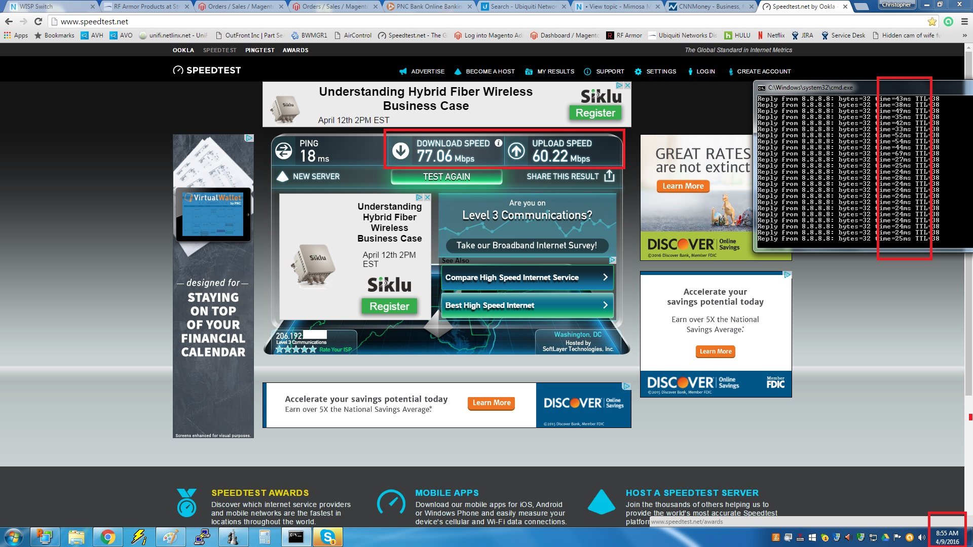

Re: Mimosa MU-MIMO ?
This is me at home on a DFS sector 30 MHz wide 3.4 miles to Blue Ball Water Tower.
Rocket M5 Sectors with RF Armor and NanoBeam 400mm with shield kit
AP has 22 clients
I have seen as high as 90+ Mbps before
AP has 22 clients
