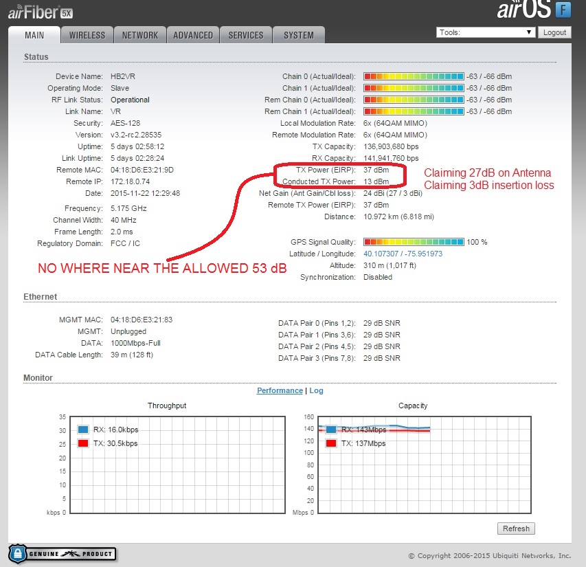

rebelwireless wrote:New FCC rules are brutal. AF5X is more-or-less losing 2-4dBm vs EIRP in all but UNII3, then its 1dBm. In some bands, you can't cheat by dropping the claimed gain because the radio is output limited to 7dBm to match the smallest RD23. If you put in 20dBi it will claim 27dBm...
Well as you can see in the pic below:
I claimed 27 dB on the 30 dB Dish - reality the antenna is "maybe" 27.5 dB at best in UNI-I - Marketing fluff that hinders us
I claimed 3 dB insertion loss (.5dB per connector and .5 dB per jumper) - I know this is pushing it
As you can clearly see the AF5X limits the EIRP to 37 dB which is a FAR cry from 53 dB
Tx on the radiator is limited to 13 dB
Now this is UNI-I not UNI-III because I use UNI-III for PTMP, but UNI-I is also allowed 53 dB.
Back when I went to school 53 dB - 37 dB = 16 dB short of regs.
