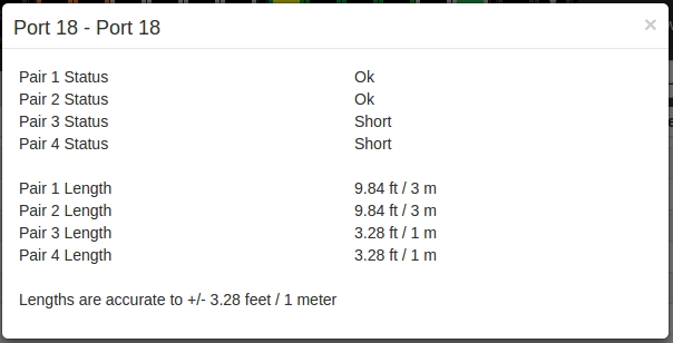

Here is an example of a cable test to a 24V PoE powered airCam.
