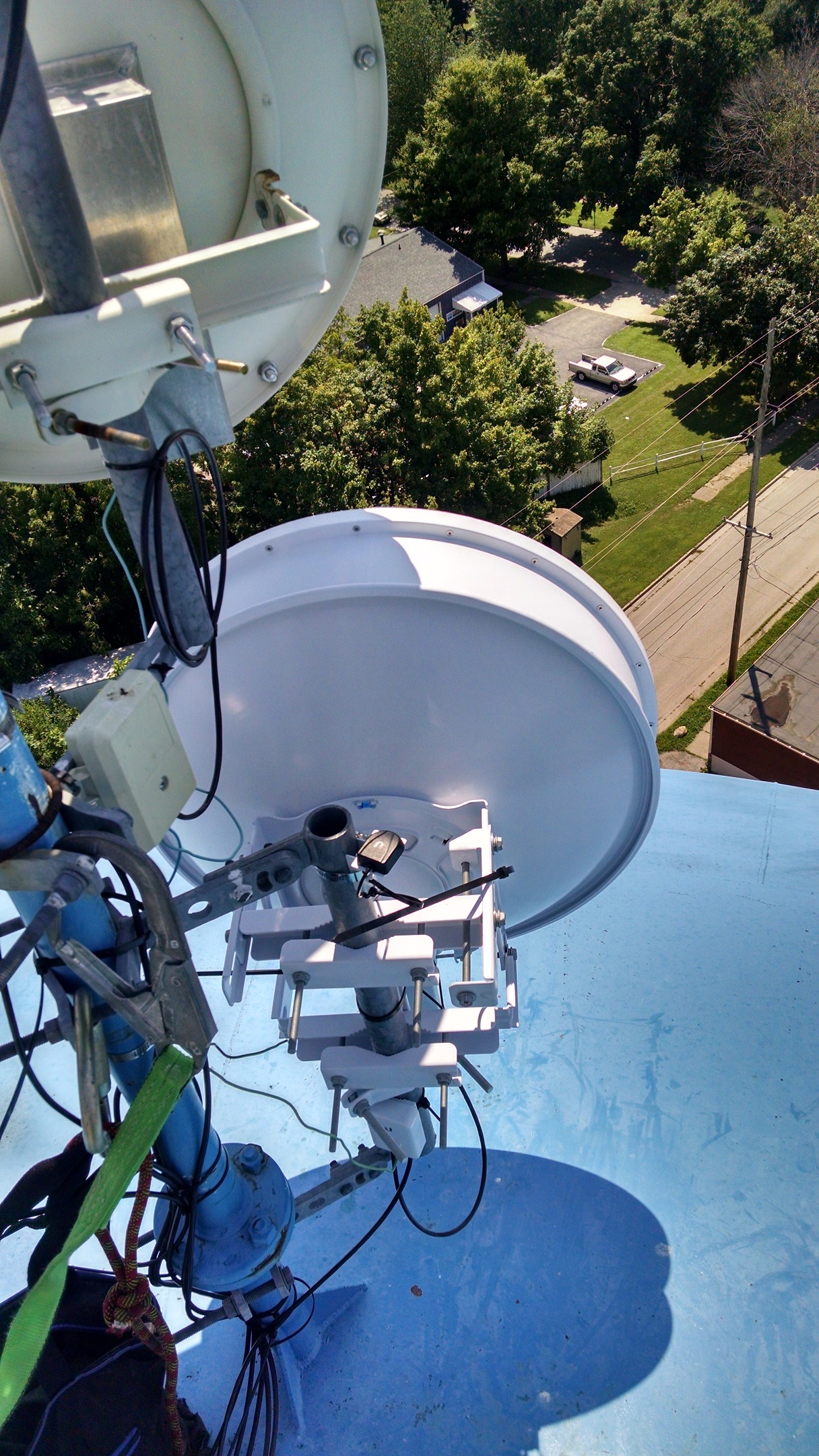

I just put one up and it is the same exact size as the RD-5G30-LW. The dish is the same depth as the feed horn. I also put up one of the ISO-Beams on the dish. Not sure if it is needed but I do everything I can to lessen any colo interference.
Re: AF-5G30-S45 Dish Shield
Posted: Mon Aug 03, 2015 4:05 pm
by sbyrd
Here is a photo.
Also have you seen the new Powerbeams with integrated shield. https://www.ubnt.com/airmax/powerbeam-ac-iso/

It does not bolt on. It has a clamp ring that goes around the edge and attaches the radome to the dish. Since everything is white it is hard to see. All you do is loosen one threaded bolt and remove the ring and the radome comes off.

sbyrd wrote:It does not bolt on. It has a clamp ring that goes around the edge and attaches the radome to the dish. Since everything is white it is hard to see. All you do is loosen one threaded bolt and remove the ring and the radome comes off.
Arrrrrrg I'm sorry, I didn't scroll down on the pic far enough, I stopped at the 2' Rocket dish and saw the bolts on it!! :headb:
Thanks for the pic and for clearing up what I was thinking! :crazy: Now it all makes sense!
