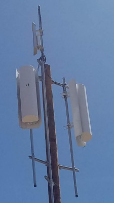

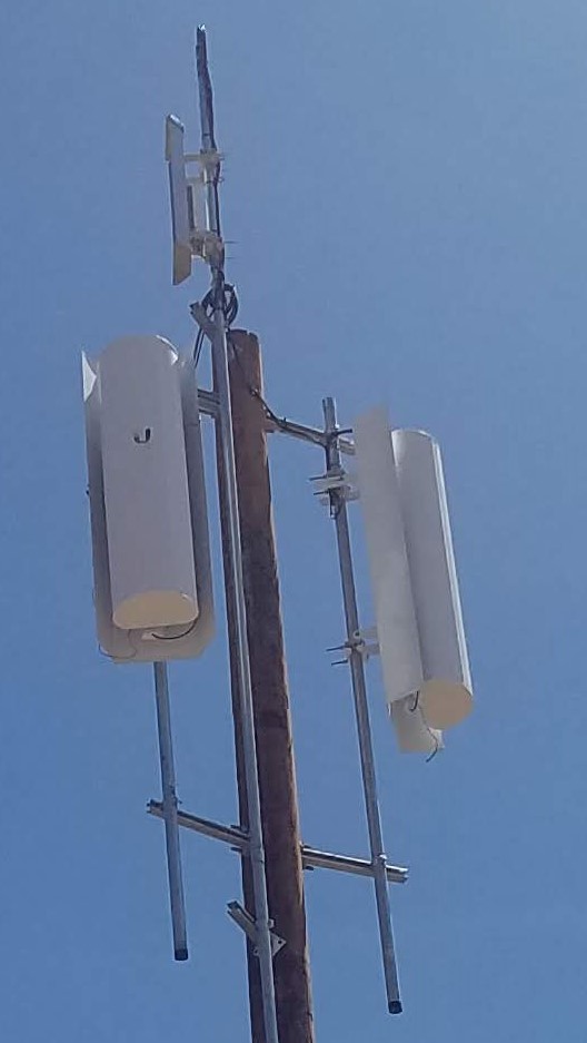

Had a competitor install this recently. Has anyone done any testing to see if this is actually beneficial for these antennas with Prism radios?

Those antennas, and the other AC antennas 45/60 degree do not need deflectors as they are built in.
AM-5AC21-60 (AC 5 GHz 60 degree 21 dB)
AM-5AC22-45 (AC 5 GHz 45 degree 22 dB)
What they do need like the above AC sectors is a Radio cover box which we make for the AC sectors above but this big boy sadly our boxes will only fit on the top and bottom radios. We need to design a special box for the middle radio.
https://www.rfarmor.com/sector-kits/uacsbx.html
Re: 5 GHz, 3x30° HD Sector Antenna
Personnally, I would use RF Element 30° horns instead.
