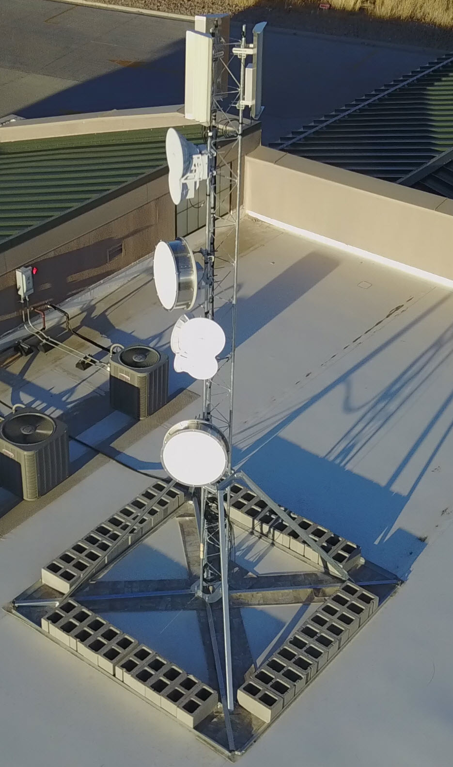

Here's one of our installs for anyone else that might be interested. We only went 20' because more wasn't needed, but as you can see we loaded it up.
3-AF24's
2-AF5X with 2ft dishes
3-120 Sectors
I'm sure most of you know how picky the AF24's are about their mount moving and we've been very happy with this setup.
We've also use these for temp towers when we recently replaced one of our towers. Although probably not recommended by the manufacture we've drilled some holes in that one to accommodate a larger slope that 2° as we were setting it on the top of a mountain
3-AF24's
3-120 Sectors
