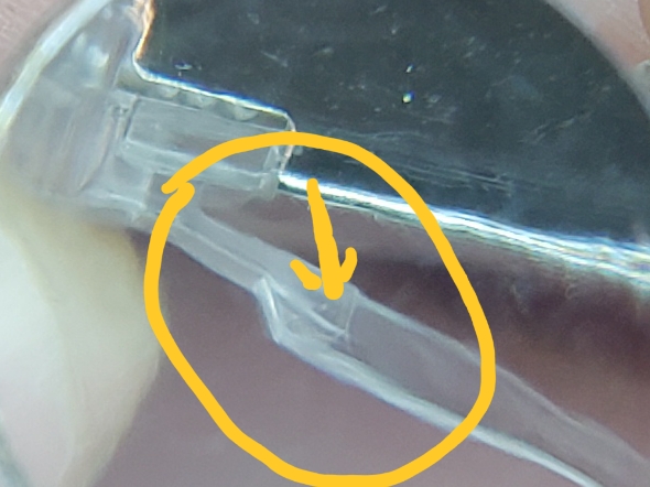

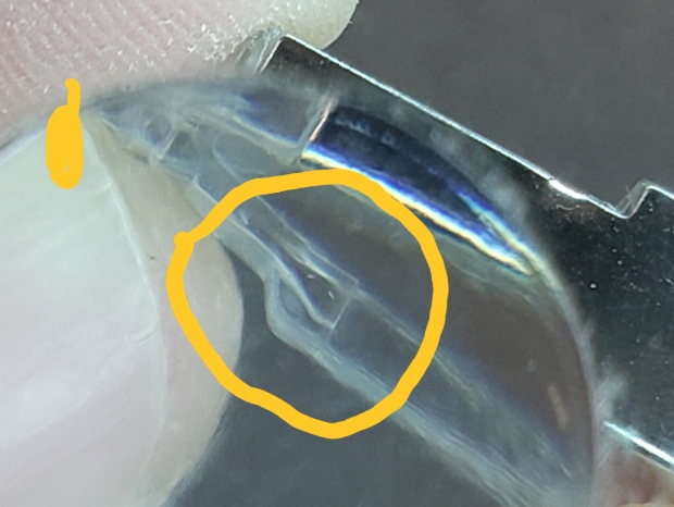

And here is the difference between the two. Notice the sear edge is pointed on the non numbered end. And has the point removed and is tapered on the numbered ones.
This, coupled with the cambiums radio port design, is causing the issue i believe.

It is now my belief that with the different sear point (and slightly taller tab spacing from that reduction), and Cambiums port design on the 190 unit reducing the relief cut of the tab. The tab is NOT able to fully engage in the sear lock, causing the issue.
