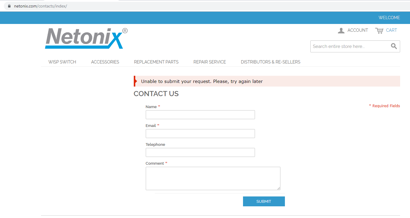

I have tried to send a request via the "Contact Us" page but all i get is an error "Unable to submit your request. Please, try again later."

As far as I know the contact us form is working on the RF Armor site and the Netonix site as we are getting emails.

I dont make this up, it no work on multiple computers here3 so....(chrome or firefox)

Hmm, I will look into the contact us but I get emails every day? - ODD????
