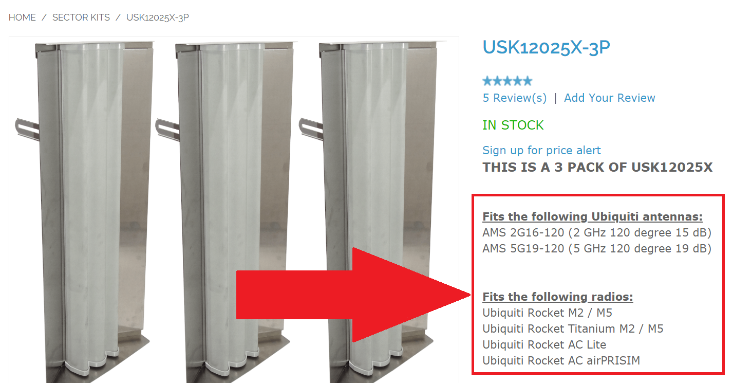

I appreciate the reply, but I see nothing in the RF armor line that can be used with a 2GHz sector and one of the new 2AC Prism units. These AC's are similar in size and shape to one of the Rocket Prism 5AC PtP units that are quite a bit taller than the older Rocket M5's. The key to these 2.4GHz AC's is that they have a "Mixed Mode" that lets them operate with older 2.4GHz CPE, and increases capacity with the Gigabit Ethernet interface. AFAIK, there is no lite version of the 2.4AC AP.
Re: Rocket 2AC Prism and AirMax 120 Sector
Say what?
All of our current shield kits will accommodate the airPRISIM radio and even the AFX radios.
I own a WSIP and use most all the UBNT radios.
There is a video in the post below showing how an airPRISIM radio fits in the current shields we have been making for almost 2 years.
https://forum.netonix.com/viewtopic.php?f=38&t=3050#p22918
Once again I refer to this video which clearly shows that airPRISIM radios do in fact fit in any sector kit ending in "X"
https://www.youtube.com/watch?v=laaV2Cp ... e=youtu.be
We also make a radio shield box for the back of AC and AF dishes and sectors that fit the newer radios.
These boxes fit on the back of AC sectors that have built in deflectors
https://www.rfarmor.com/sector-kits/uacsbx.html
These boxes fit on the back of the AF dishes that the dish extends beyond the stem focal point.
https://www.rfarmor.com/dish-kits/uds5g23-s45.html
https://www.rfarmor.com/dish-kits/uds5g30-s45.html
This replacement box upgrades older Dish kits with a larger box to fit airPRISIM or AFX radios
https://www.rfarmor.com/dish-kits/uds25.html

OK, sorry about that. Your website is not very clear on this, and the changes in views of the products don't work in Firefox on Linux. Would like to see other details, so maybe some other browser will do that.
I'm pretty sure this location already has the original RF Armor shields for the 2GHz sectors, but unlikely that a new radio box will fit on them. So I am looking at a complete set of shields for a 3-way array, I guess. Since the radios themselves are in metal cases, I suppose you could even run them without a box. But would lose the direct water contact protection without a box.
Was trying to use some spare sectors that I have and make up the whole array ahead of time to minimize the time my climbing crew has to fiddle with small hardware on the top of the water tank. Since the object is to change the radios, drop the old array down and hoist up the new one and mount it.
Open to any other ideas you might have on this.
I never changed the pictures on the kits but the Product DESCRIPTION clearly states what antennas and radios they fit.
Also there is a reason for the BOX, yes it makes a BIG difference, REPLACE the whole kit or use the Rocket AC Lite which is what I did at my WISP as unless you need channel reuse / sync I see the same performance.
