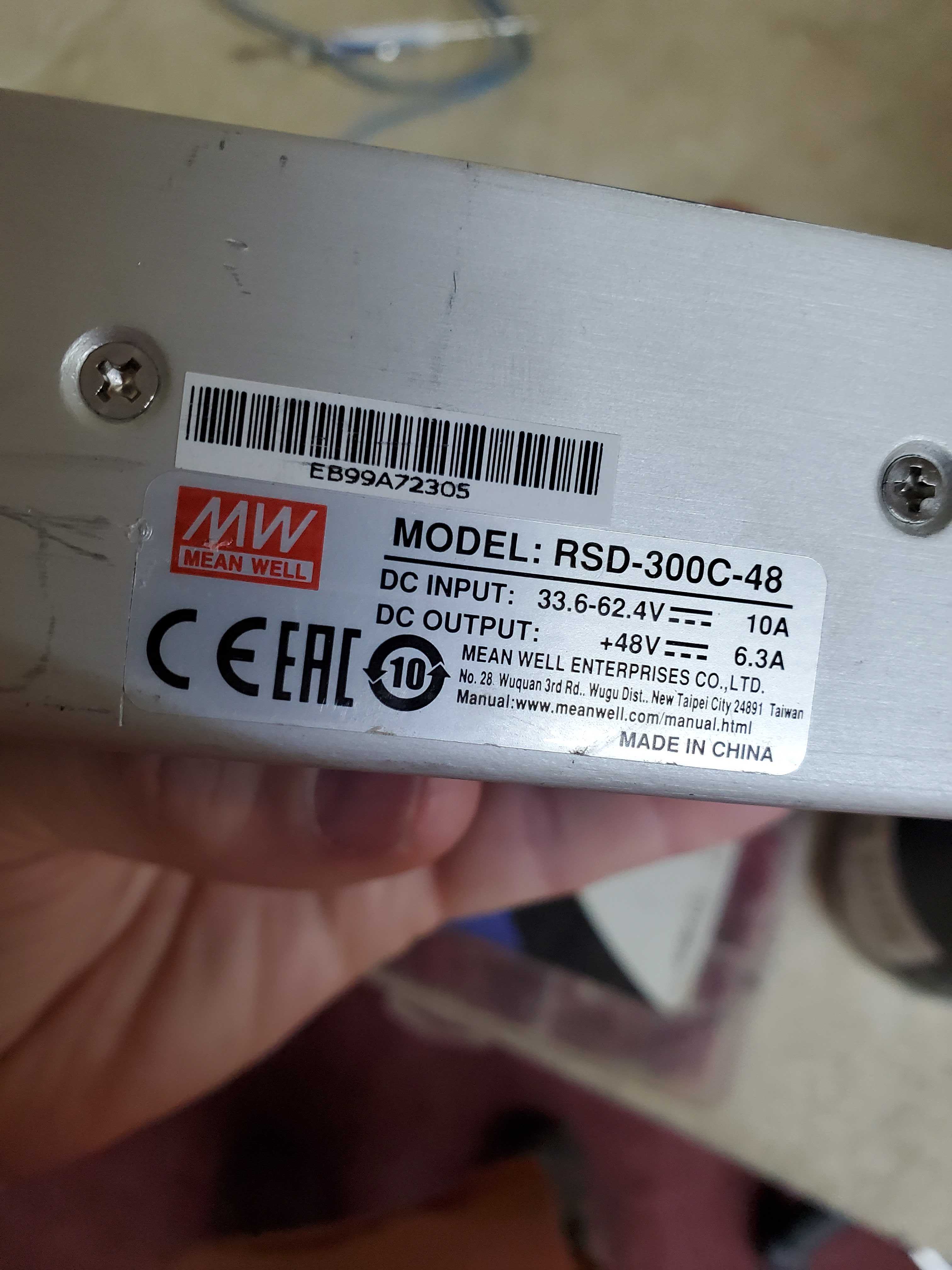

There is a way to convert -48 to +48. We have used it on multiple sites (more than 10).
It's a Meanwell unit, Model: RSD-300C-48
