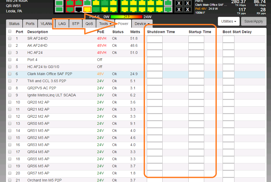

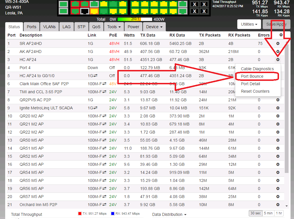

Do you mean by clicking the gear on the far right of each port row and selecting "Port Bounce" ????

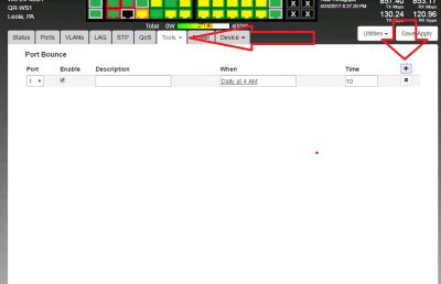

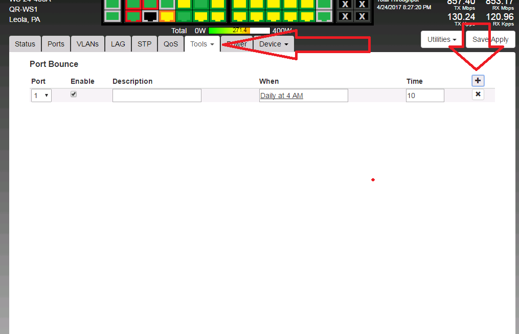

Or the scheduled port bounce that you can schedule to bounce POE on a port Once, Daily, Weekly, Monthly?
Or the scheduled POE OFF and ON each day based on time?
There is not much if any in a UBNT switch we don't have?
You really should look around the UI for more that you don't know is there.
Re: POE control
Power cycle is probably a better term to use than Port Bounce
