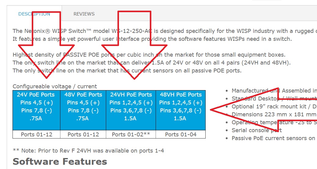

sirhc wrote:Yes and you can power with (3) POE bricks or (1) WS-12-250-AC
Whats the max Watts per port on the WS-12-250-AC ?
Thanks.
Re: WS-6-Mini Chaining
now wrote:Whats the max Watts per port on the WS-12-250-AC ?
CLICK IMAGE TO VIEW FULL SIZE
Do Volts times Amps to convert to Watts
50V X 1.5A = 75W
50V X 1.5A = 75W
