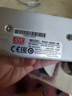

We have a few -48DC sites that have small air conditioned 19" enclosures that are too shallow for the WS-26-400-IDC. We could get away with a 12port switch for our POE needs. Will any of your other products work in this environment? Are there ways to convert a -48dc feed to +48? If so can you made device suggestions?

The IDC model is the only one that can be use with -48V.

There is a way to convert -48 to +48. We have used it on multiple sites (more than 10).
It's a Meanwell unit, Model: RSD-300C-48
