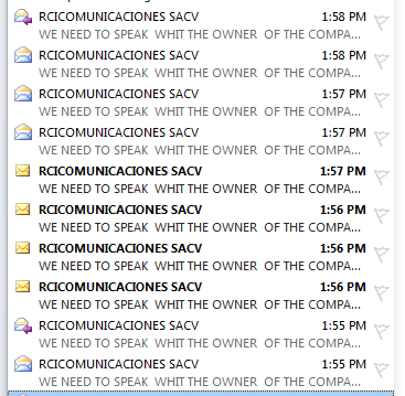

rcicomunicaciones wrote:Also we didn't receive any help from Chris. the only response that he sent was "If you continue to spam this email address our spam filter will determine you are spam and could block your email address.".
We do appreciate your time and help. Congratulation about the great features of the products that you have.
You were sending email after email, one right after the other asking the same question over and over again which was you wanted phone support. We had already answered you that we offer support on the forums but you kept demanding a phone support call. See screen grab below of some of your email spams. We were being serious and truthful that our spam filter would eventually flag your email address as SPAM since you were sending the same email over and over and over again. *as seen in picture below*
