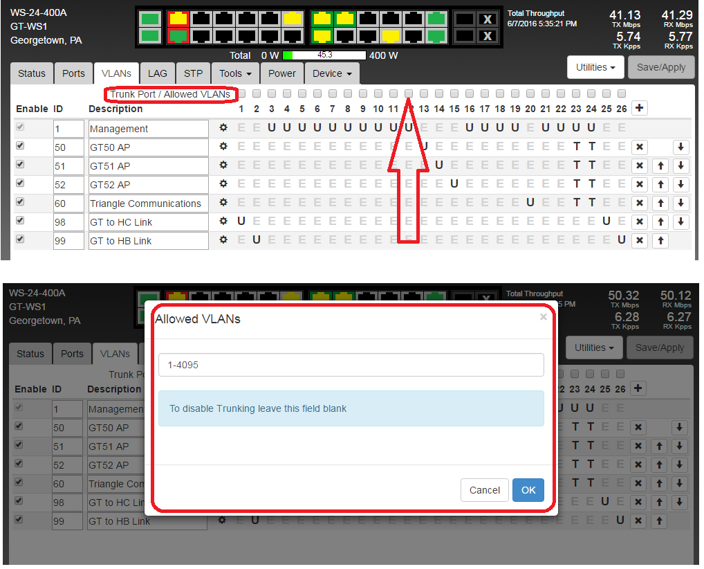

But I digress, if you look at the VLAN Tab there is a Checkbox called "Trunk Port / Allowed VLANs" above each port.
You can then define a list of allowed VLANs for that port but remember you need to add that list to both the ingress and egress port or the packet will be dropped.
A list can be like this is you want "100-200,205,217,1000,-1925,4012"
