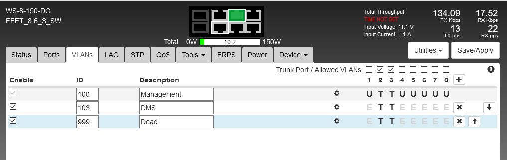

Here is a sample of one of the switches I am trying to configure. Port 3 is the radio to this site. The management vlan needs to be able to see everything on that vlan on the network and does not. The DMS communicates on that vlan but is not remotely accessible on that vlan. The DMS will be in port 2. Do I untag port 2 and management ports and tag them going out port 3?
Re: vlans over a trunk not working?
With current config, vlan 100, 103 et 999 will pass tagged through port 2 and 3. We would need to know the config of the devices on port 2 and 3. Do you detect any mac address on those vlan ?
The're was also a bug about forwarding with some switch when the came out of the box. Try upgrading at 1.5.6 if you didn't do it already.
