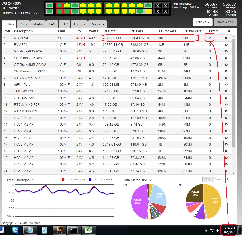

Another thing you can do is SSH into the AF and check the Errors on that side, the linux command on the AF24 radio to view Errors is "emacstat"
I know this is a 24 port but it is the "exact" same design as the 12 port.
As you can see below is a switch that has been up for 50 days and only had 2 CRC errors on my AF24 link. - I JUST TOOK THIS SCREEN SHOT
AF Errors.jpg (338.77 KiB) Viewed 60817 times

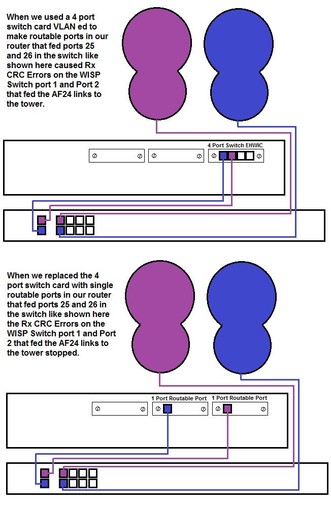

Another thing we have found is we were using a 4 port EHWIC switch card in our Cisco 2951 router and VLANing the EHWIC ports off to make them routable ports in the router and we found that when we did this and fed the AF24 with one of these ports that the switch port feeding the AF24 would get CRC errors during heavy load. This might be because the router was mangling packets with all the overhead or because the EHWIC had to handle each packet 4 times when passing packets in one AF24 link and out the next to the next tower.
WHen we replaced the EHWIC with single ROUTABLE port EHWICs to feed the WISP Switch port that was bonded to the port that powered the AF24 that CRC errors were MUCH MUCH less on the port feeding the AF24 almost NON Existent as seen in screen grab above.
I know you are going to say I am crazy but SERIOUSLY this example below is what we found. Do not ask me why, I did not care it just stopped the errors.
Trust me I just spent 45 minutes in MS Paint to show you this so if I did not think it "might" so how relate to your issues I would not bother but it could but I would start with checking the wiring and grounding then look at this.
AF Errors2.jpg (163.2 KiB) Viewed 60814 times
