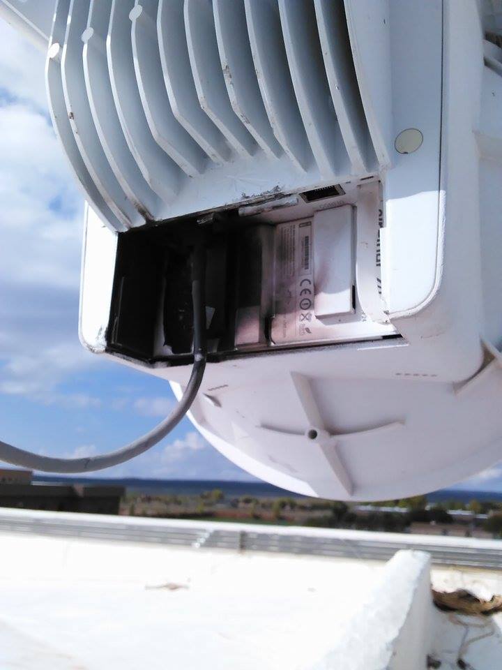

So in this case you did good, a $3,000.00 +/- radio fixed for $400.00 + shipping each way so less than $500-$600 total.
But I will say this looks like either a massive amount of ground current or a direct strike on the tower.
Make sure your tower grounds are bonded to the electrical service ground rods.
I would also put in a NEW service ground rod and bond to existing service ground rods which I had to do recently at one of my sites doing damage to AF24HD radios.
Actually AF24 is not susceptible to ground current damage like the AF24HD is if you do not hook up the ground lug on the AF24 as that radio is insulated from the tower just like a NanoStation whereas the AF24HD with the aluminum housing is bonded to the tower and the tower ground.

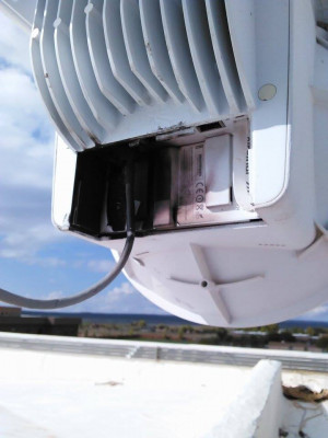

Already on it's way. I wasn't super hopeful when the "L-word" was used (lightning), to be honest, but thankfully the visions I had of this:
weren't accurate.

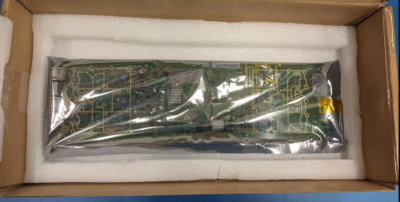

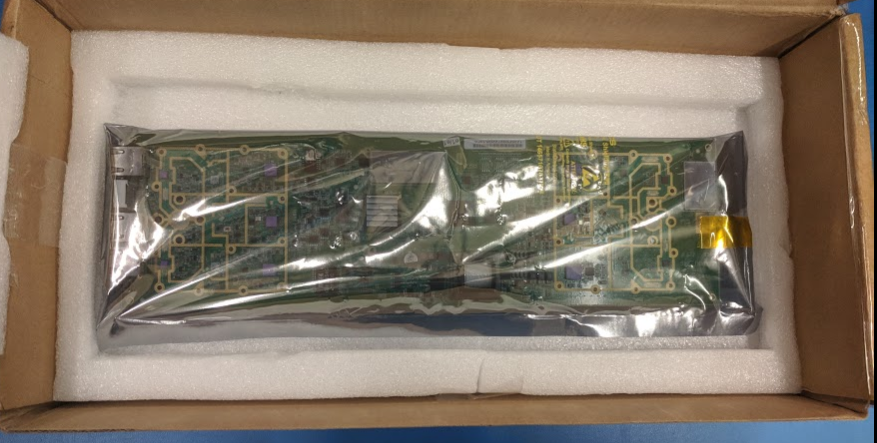

So, I got an interesting one from overseas the other day (New Zealand), and the way it was packed was exactly what I'd like to see.
Especially for you international guys, it just makes sense.
Not only does this take 90% of the grunt work out of fixing the thing (which saves you money), it also saves you money on postage.
Now, a few things about disassembling these --
1. Save the little plastic caps you pop off. You should end up with 11 total, including the one under the UBNT sticker.
2. Use the right screwdriver. #2 blunt nose phillips with a long shank will do nicely. You need the long shank as some of the screws are very deeply recessed. The screws are stainless steel, if you strip one, you might as well just chuck that housing.
3. When separating the heat sink from the reflector, lift slowly and straight - the antenna poles are just glued together and may end up rattling around the inside of the reflector if you're not careful, since there's not much clearance room - If they do, though, glue 'em back on, no big deal. The GPS antenna connector can also make this tricky, there's a plastic plate you have to detach from the reflector assembly.
4. You then have about a million screws attaching antenna poles through the board to the heat sink with longer screws, and 2 shorter screws attaching the board between the two poles. HDs will have cable brackets holding the GPS cable in place, you do need to undo those screws as well.
5. When you do finally separate the antenna poles from the board, there're some pinkish purple thermal blocks that are absolutely critical to reliable operation - they may stick to the board, they may stick to the shielding - You want all of these on the board.
That does it for disassembly. Reassembling your unit is pretty simple if you just reverse the sequence. Make sure your thermal blocks are in place, and make sure your screws are only hand-tight. When putting the heat sink back on the reflector, make sure that the white silicone weather seal is in place, leaky radios don't work long.
