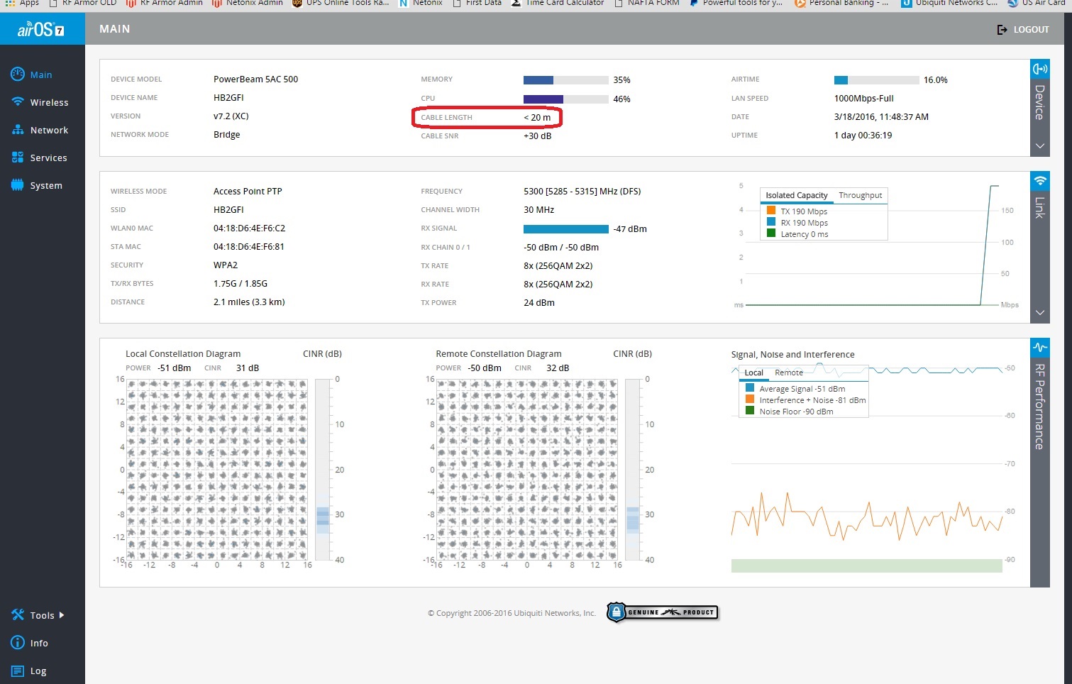

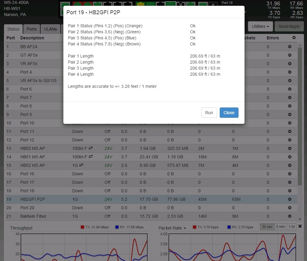

You know the more I think about this the more I remember seeing this in an airMAX AC radio as well?
I think I said something to Matt Hardy at UBNT about it, let me go look it up.....
This was a skype message I sent to Matt back on March 18th, 2016 and 2 pictures I sent him
My guess is they are implementing their cable diagnostics while their PHY is still negotiating?
Not sure what we can do about it? I really do not like putting in a kludge like that if all possible.
You need to have the programmers fix the reported cable length on the PowerBeam 5AC 500. It reports <20 m when the actual cable length is 200+ feet. Not sure if this affects other AC devices. firmware v7.2(SC) (fear)
