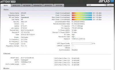

Curious what the best signal and modulation anyone has gotten with AF24 HD
Our link 2.453 miles - 59-60 dB - QAM64
Wondering if we could do better, would love/need if possible for this link to get QAM256
Best signal AF24 HD
Best signal AF24 HD

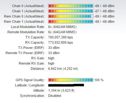

@ 2 miles but I know it could be align better on the remote side.
Chain 0 (Actual/Ideal): -59 / -58 dBm
Chain 1 (Actual/Ideal): -63 / -58 dBm
Rem Chain 0 (Actual/Ideal): -61 / -58 dBm
Rem Chain 1 (Actual/Ideal): -61 / -58 dBm

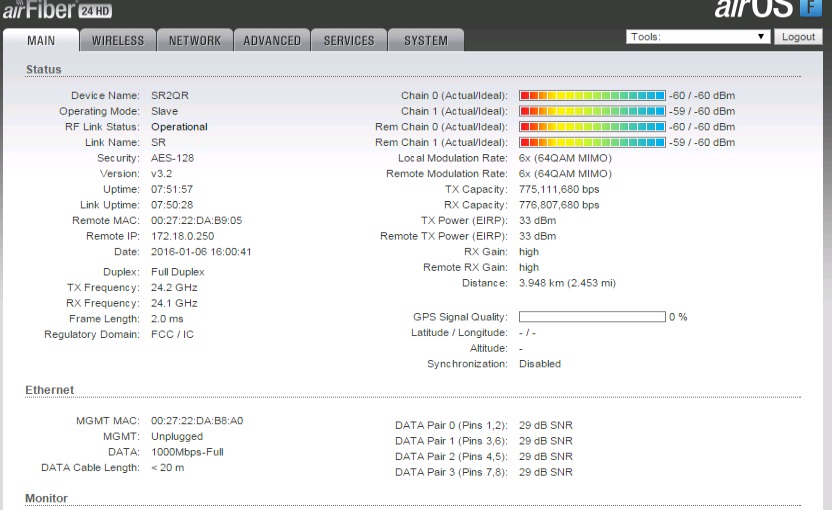

I understand your link is 2.4km further than this one we have shown below, however here is an example of 256QAM and seeing both the TX & RX capacities exceeding the specs.
We literally had this link sitting at 64QAM, and were stumped why we couldn't get any better.....then.....we lowered the power. ;-)
Curious, drop down 2 or 3 dBm and I'd be curious if you see an improvement.
Under 5 miles, these things SCREAM and really perform.
Let me know!
Chris
Let me know!
Chris

Re: Best signal AF24 HD
what is the threshold for 256QAM in signal? Is it similar to the AFX line? If so, doesn't look like you have any room to drop power because you'd need around -60 for 256QAM...
