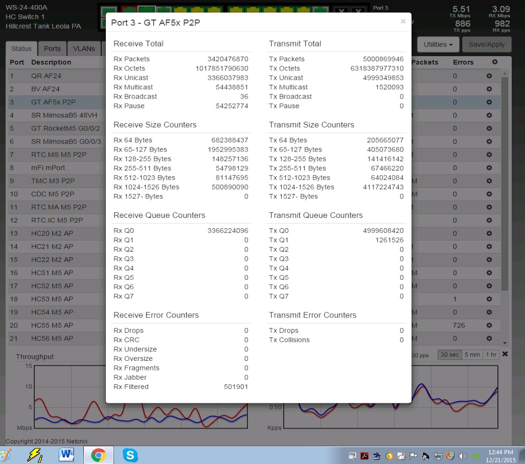

We have several AF5X Links running, the port's these are plugged into seem to generate a lot of CRC errors. This is on the AF5X port and also some downstream port's until it reaches the Mikrotik Routerboard.
No other UBNT Devices seem to generate these port errors, it's just the AF5X's.
Has anyone else had a similar issue?
We are running 1.3.8 Firmware on the Netonix Switches (24-Port, 12-Port and 6-Port)
The AF5X's are running 3.2.28594

Hi,
Thanks for the quick reply,
The cable test on the port returns OK, however it also shows the cable length as 1m (I think it's around 3m)
That port has around 18,000 Errors.
We are using Toughcable and the same plugs as with everything else however the only difference is the AF5X. (Thus I don't believe it's a Netonix Issue)
Mike
Mike
