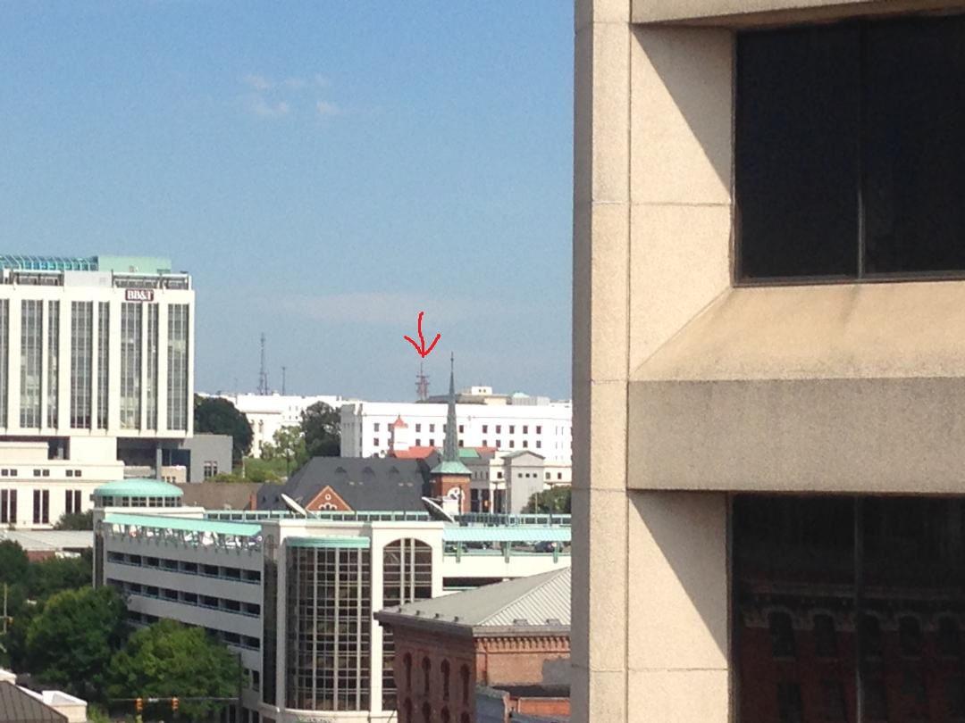

Right now i have two Power Beam ACs on this link but was thinking about going AF24 or AF24HD if i get my main link upgraded more...... do yall think i will have any issues with the corner of the other building being so close? The power beams are doing pretty good but the chains are off by about 5 to 7 db.... i'm guessing from the corner of the building.... distance is 1.3 miles

shouldn't be an issue. The fresnel zone on 24Ghz is very tight. Go with the AF24HD if it's your only link. 1.3Miles on the AF24 could fade in heavy rain a bit on you. If you keep the PBE in place then the AF24 may be worth it. You could use a pair of TE tunnels to 'JOBL' (just a bunch of links) bond the AF24 and PBE with the PBE as the second path in the TE tunnel if you need to maintain throughput when/if the AF fades.
