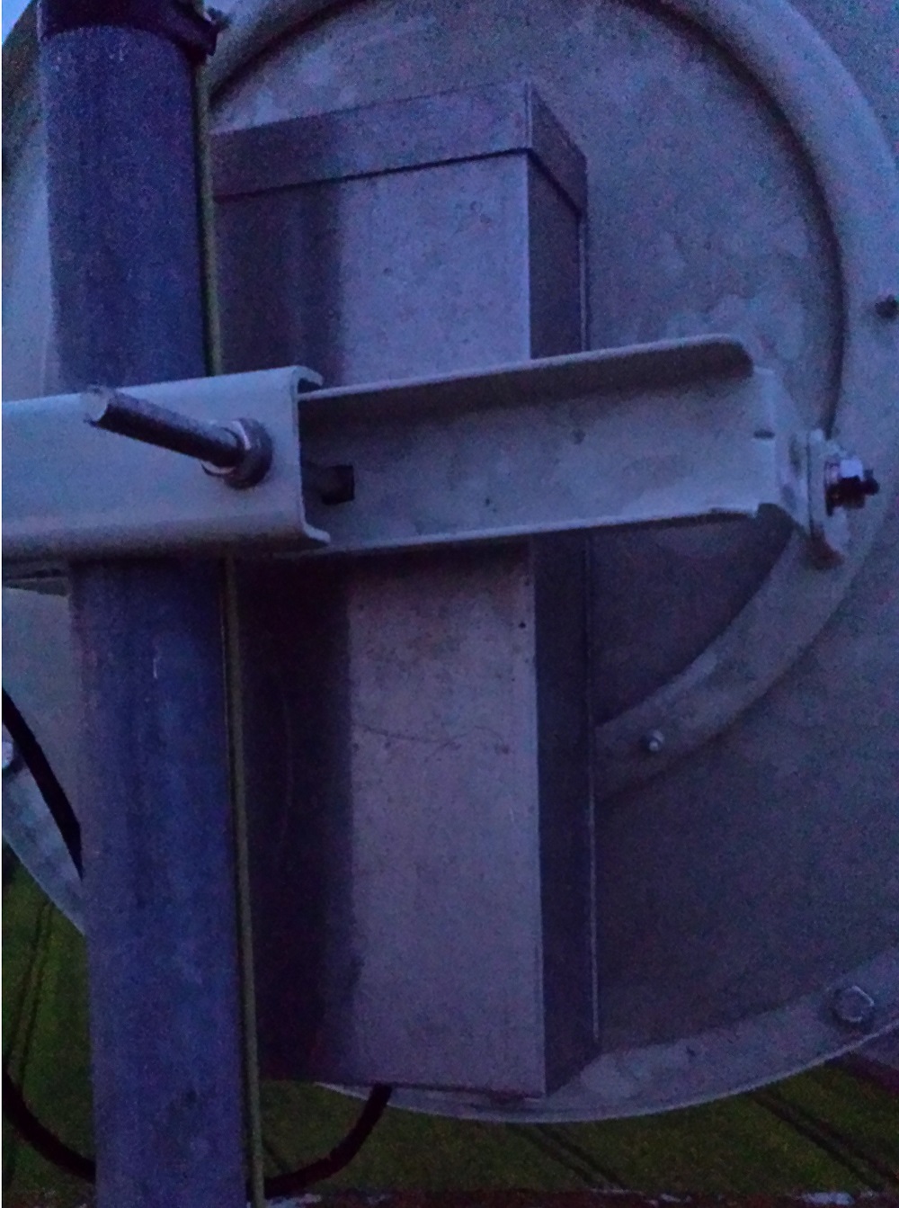

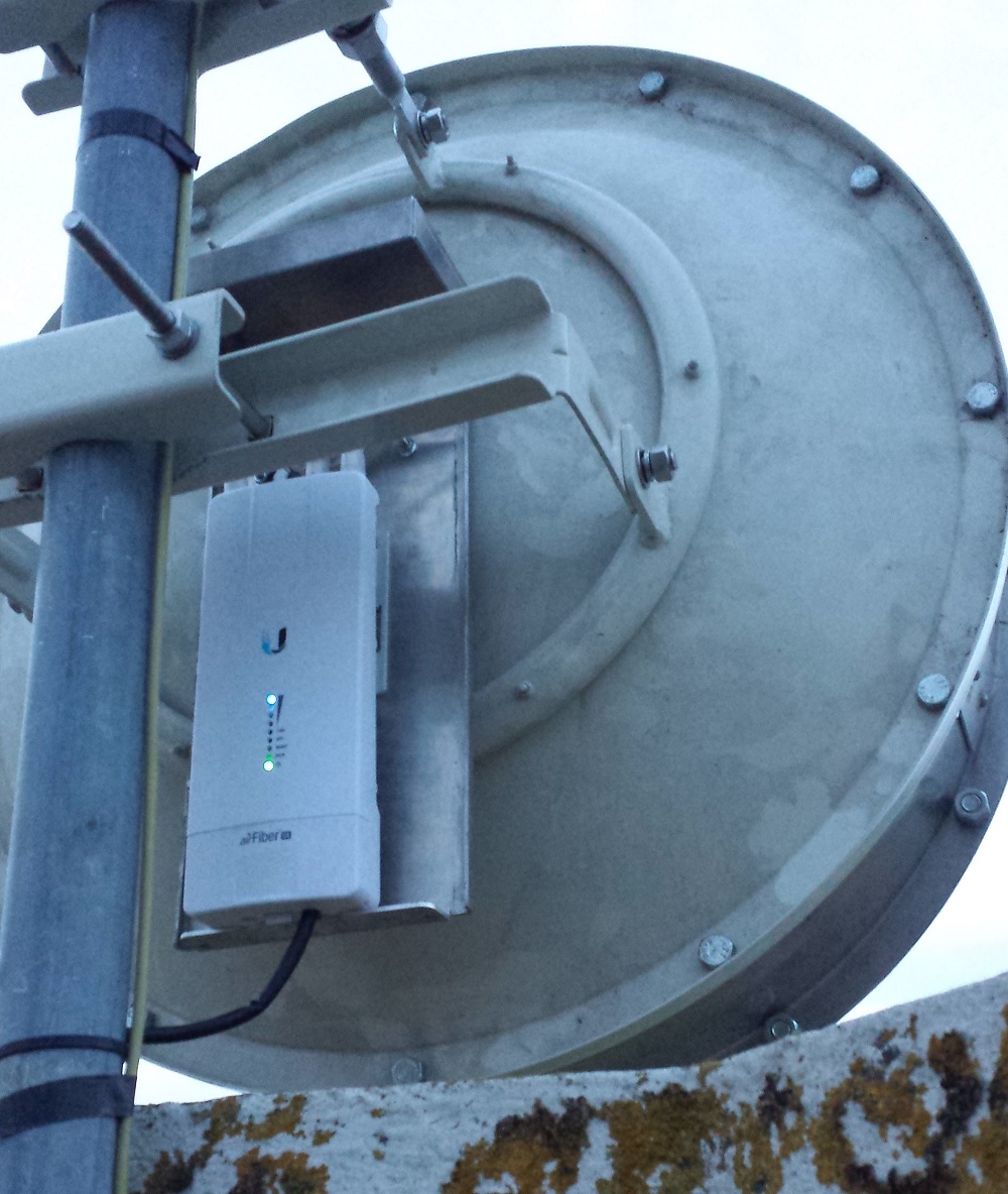

Just installed an AirFiber 5X in a Rocket Dish 30 dBi shield box.
Since I didn't install the slant conversion kit, the AF-5X is just connected with the cables not mounted inside the box.
I think with the slant conversion kit it can be mounted nicely. Also it looks like there's plenty of space around the AF-5X so that heating must not be such a big issue (at least not in my part of the world)
And with the cover on....

Since I don't have one yet, I don't understand ... does it not clip on the standard bracket anymore? I thought the AF-5X was shaped and mounts exactly the same as RM5 ??
Re: AF-5X fits inside RF Armor Rocket shield
Posted: Sat May 02, 2015 5:45 pm
by lligetfa
The H/V feedhorn gets in the way. If the slant feedhorn is used then it can clip in fully.
