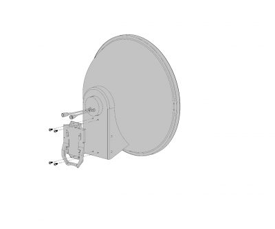

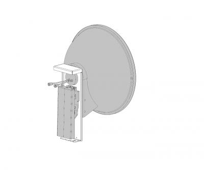

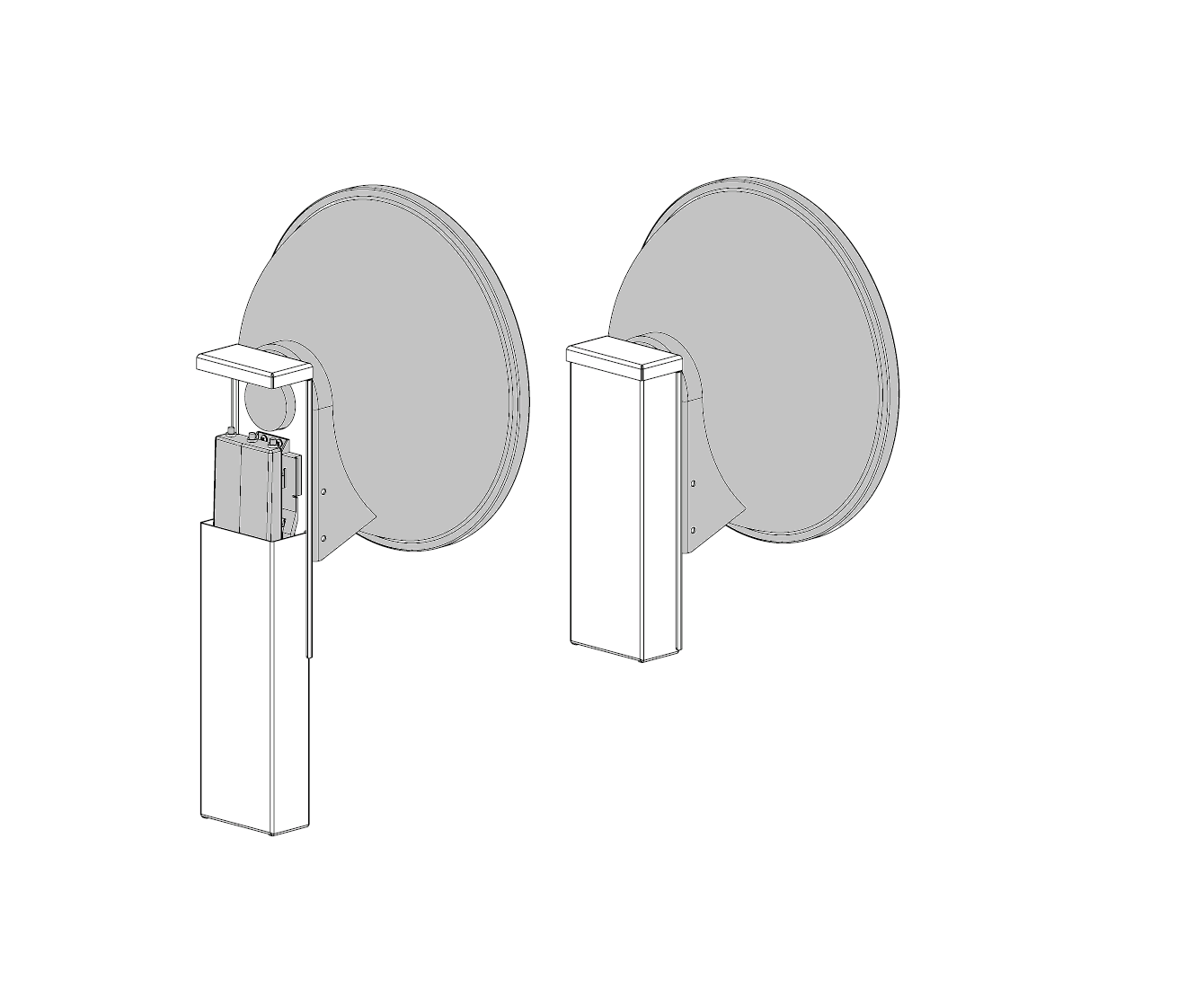

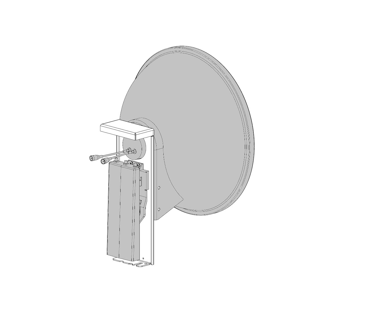

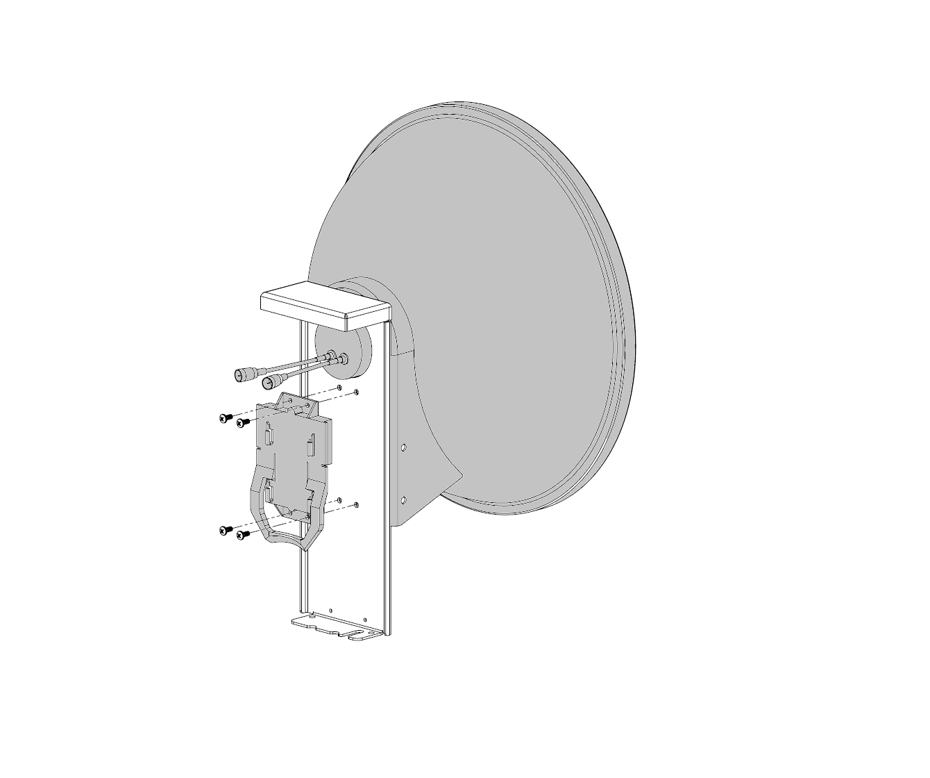

This new radio cover fits the UBNT AF-5G23-S45 dish and will fit any of the Rockets and the AF5X radio.
Made from powder coated white aluminum.
