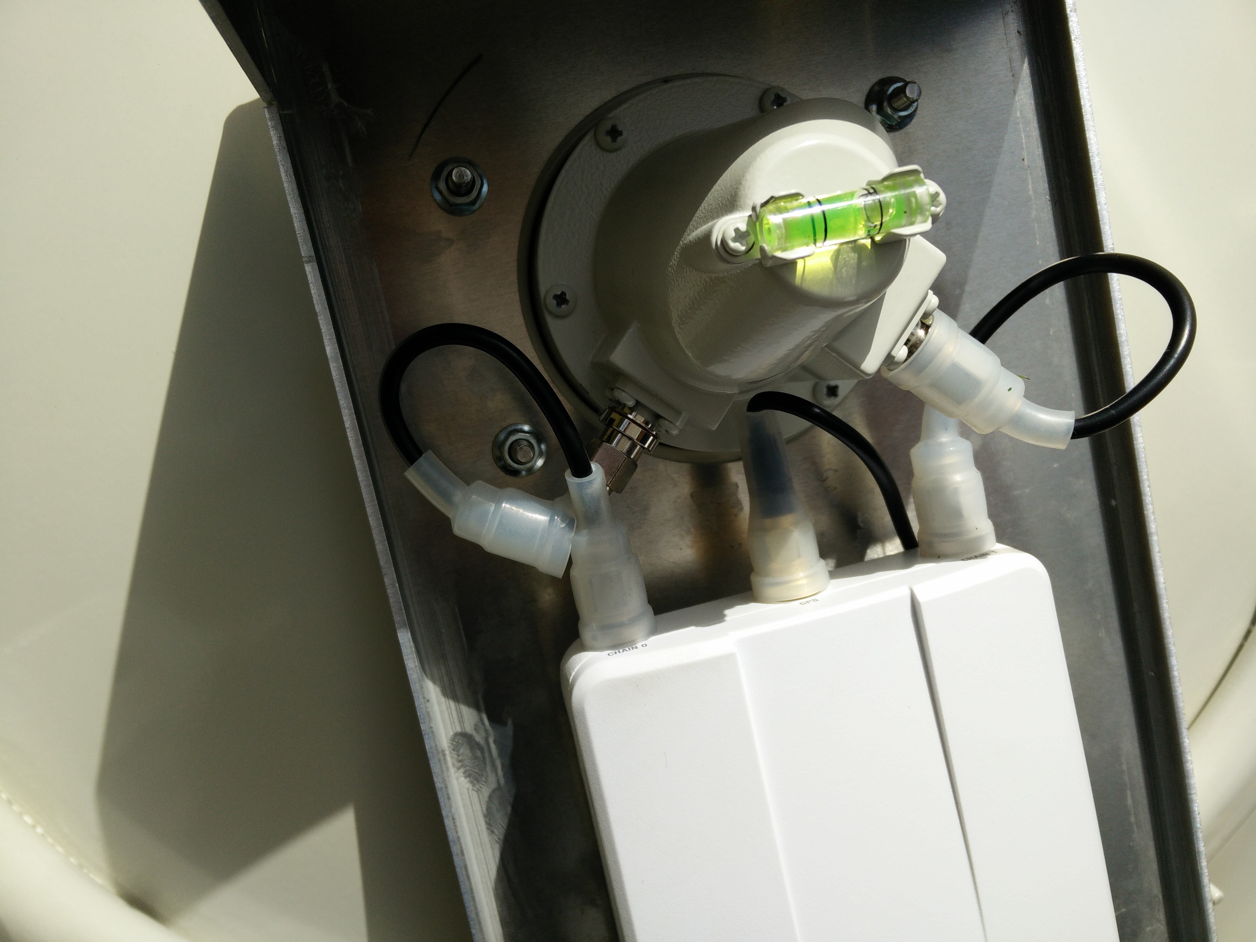

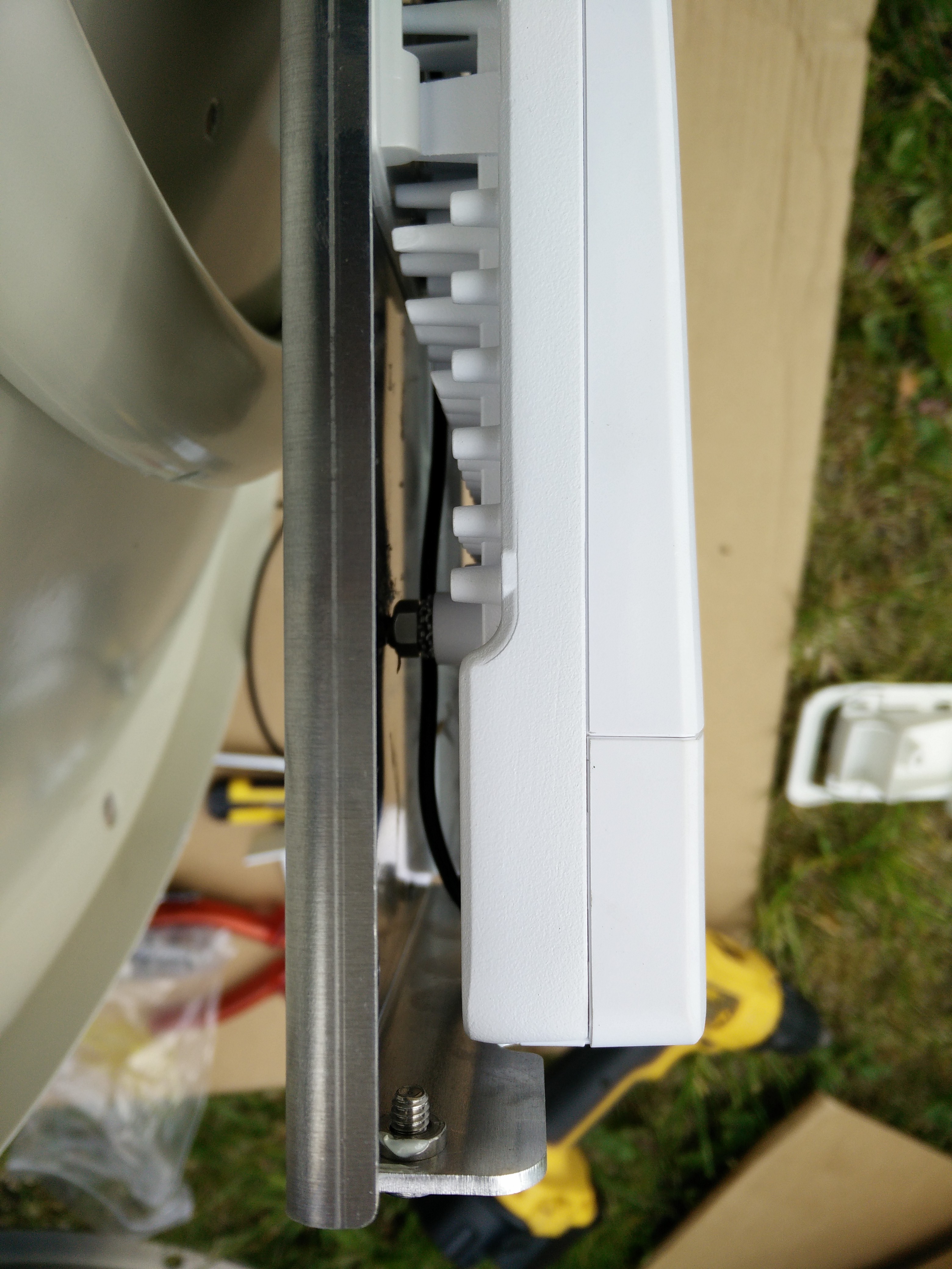

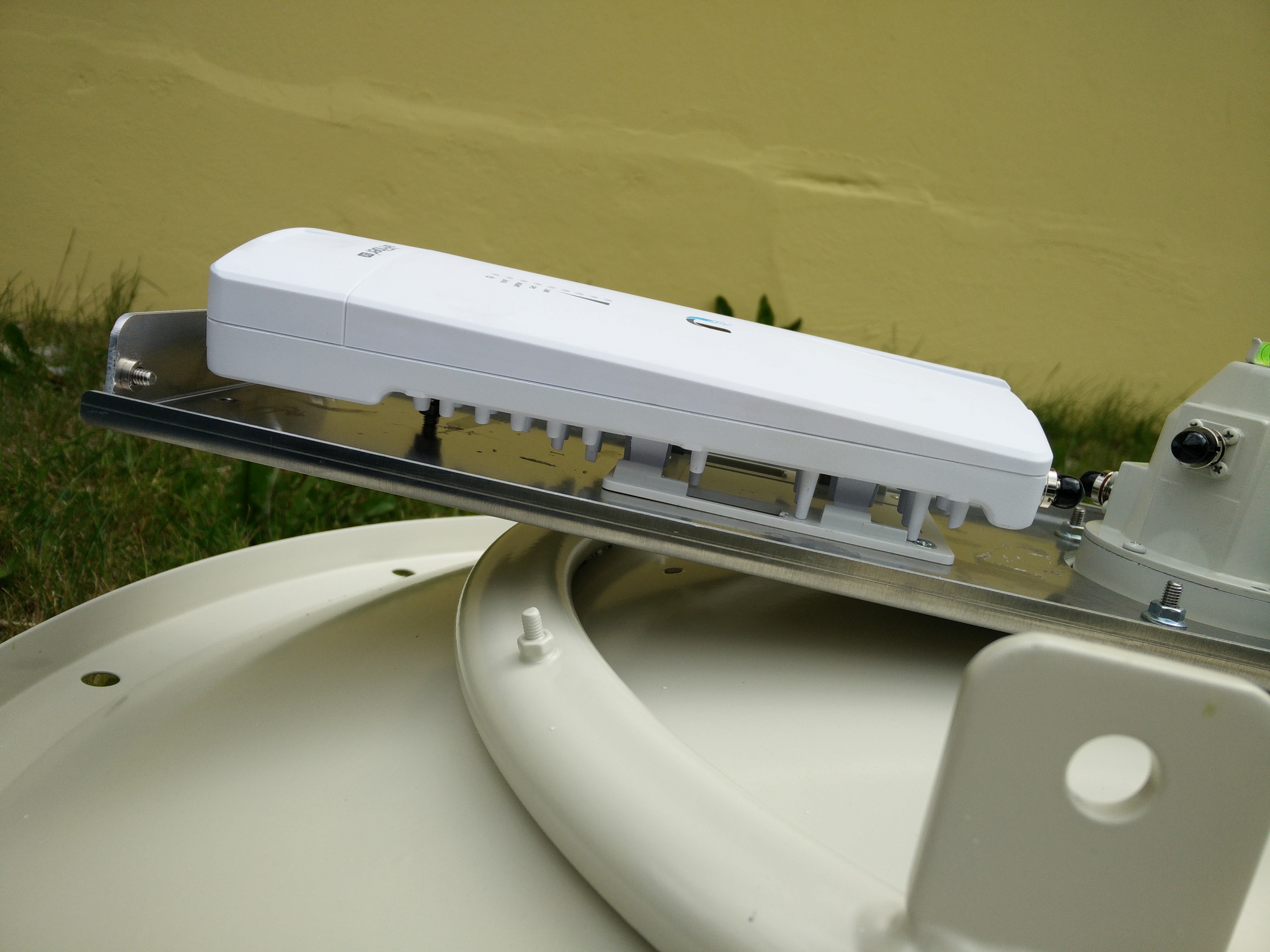

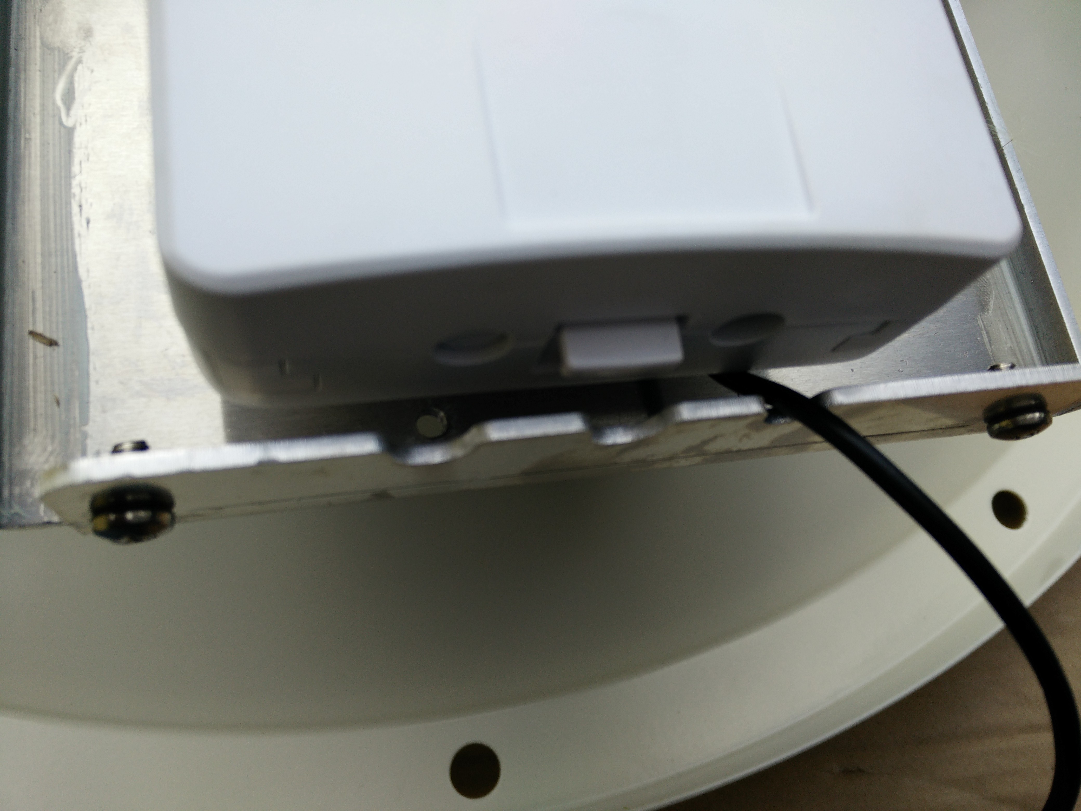

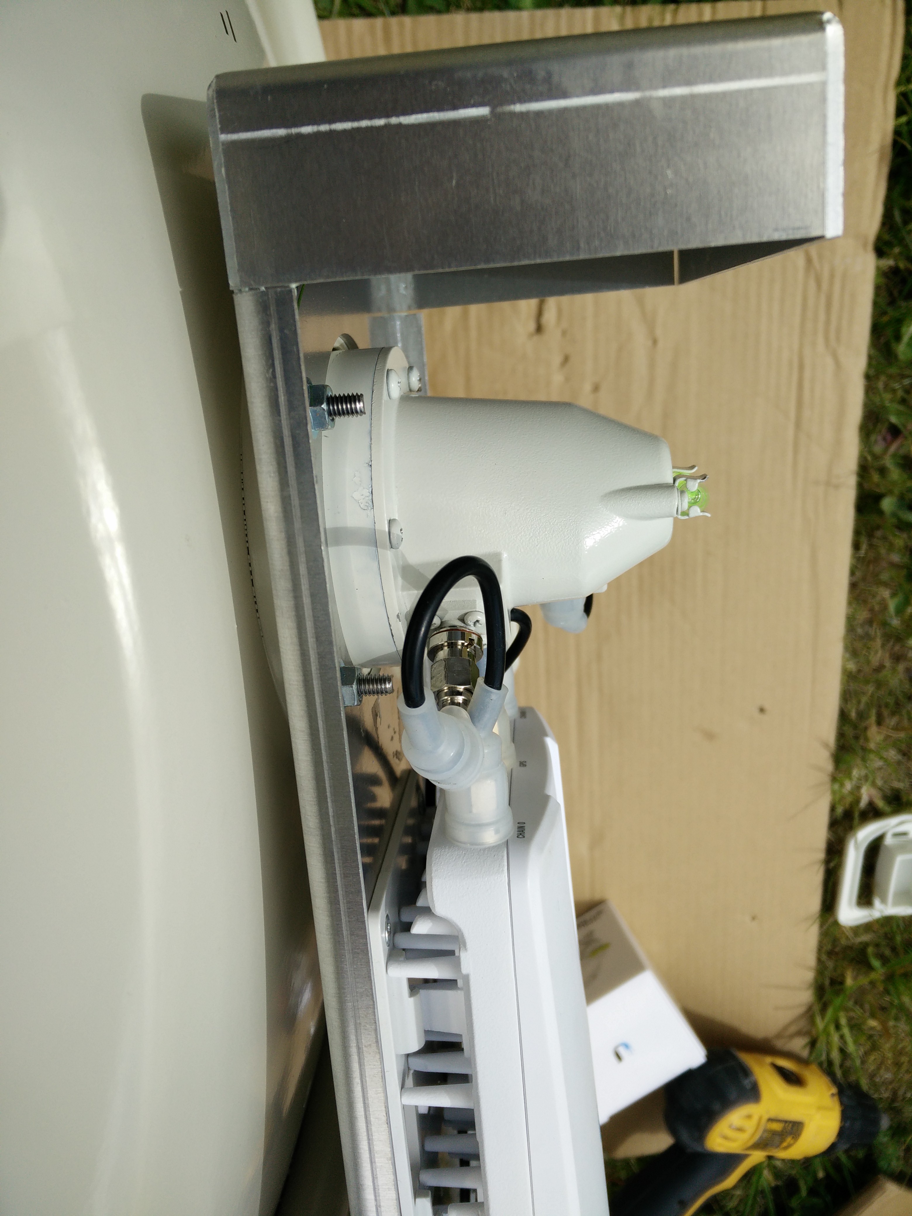

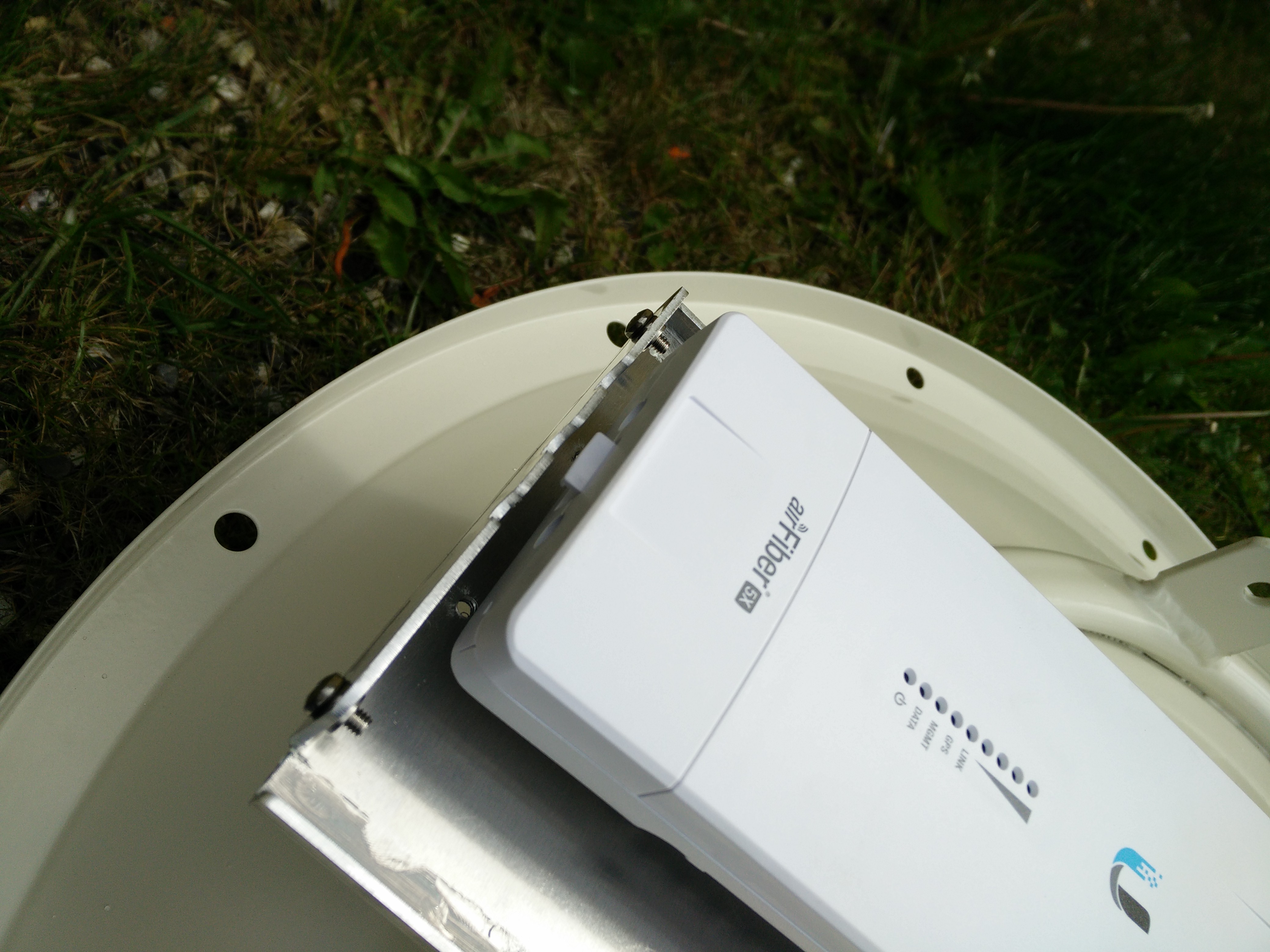

So I installed an AF-5X in a Rocket Dish 30 dBi enclosure. I have sent pictures to Chris but You guyz can see them here also...
I have now an AF5X with Rocket Dish 30 dBi installed 1.5 meters and 90 degree away from my AF5. When doing AirView from the AF5X I can't see the AF5 at all. Spectrum is clean.....
I'm thinking that it's because of the RF Armor shield case I mounted the AF5X inside.
I'm not worrying about heat. Here in Denmark it never gets that hot.....
I have to cut off some of the grounding bolt on the AF5X with an angle grinder to have the AF5X fit the RF Armor case....
