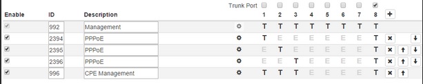

I'm having problems with tagged management with upgrading from 1.2.3 to 1.3.2.
After the switch reboots, I can no longer access the devices without having native vlan enabled on the switch facing it.

Can you post up your VLAN Tab first.
Also if there is a VLAN access list assigned to any ports (Port Trunking) or a secondary IP assigned to any VLANs.

Re: Problem with tagged management after 1.2.0 to 1.3.2 upgr
I EDITED YOUR POST TO INCLUDE THE IMAGE. YOU CAN UPLOAD JPG GRAPHICS WITH THE LINK BELOW THE SUBMIT BUTTON
I have no secondary IPs enabled.
