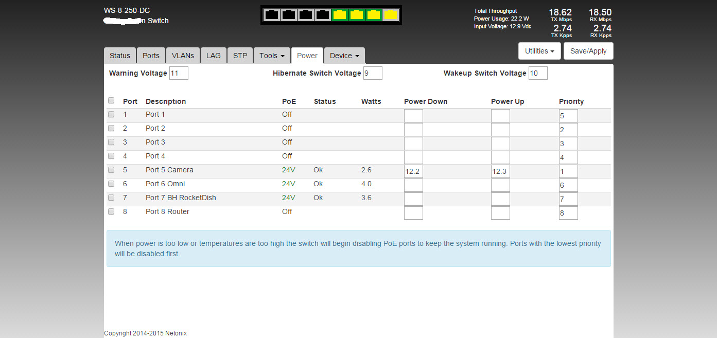

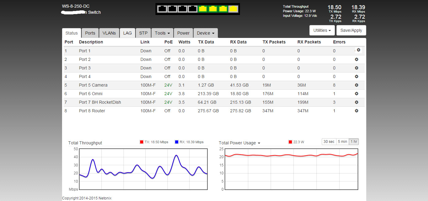

JT status.jpg (174.99 KiB) Viewed 15595 times
JT Power.jpg (144.29 KiB) Viewed 15595 times
