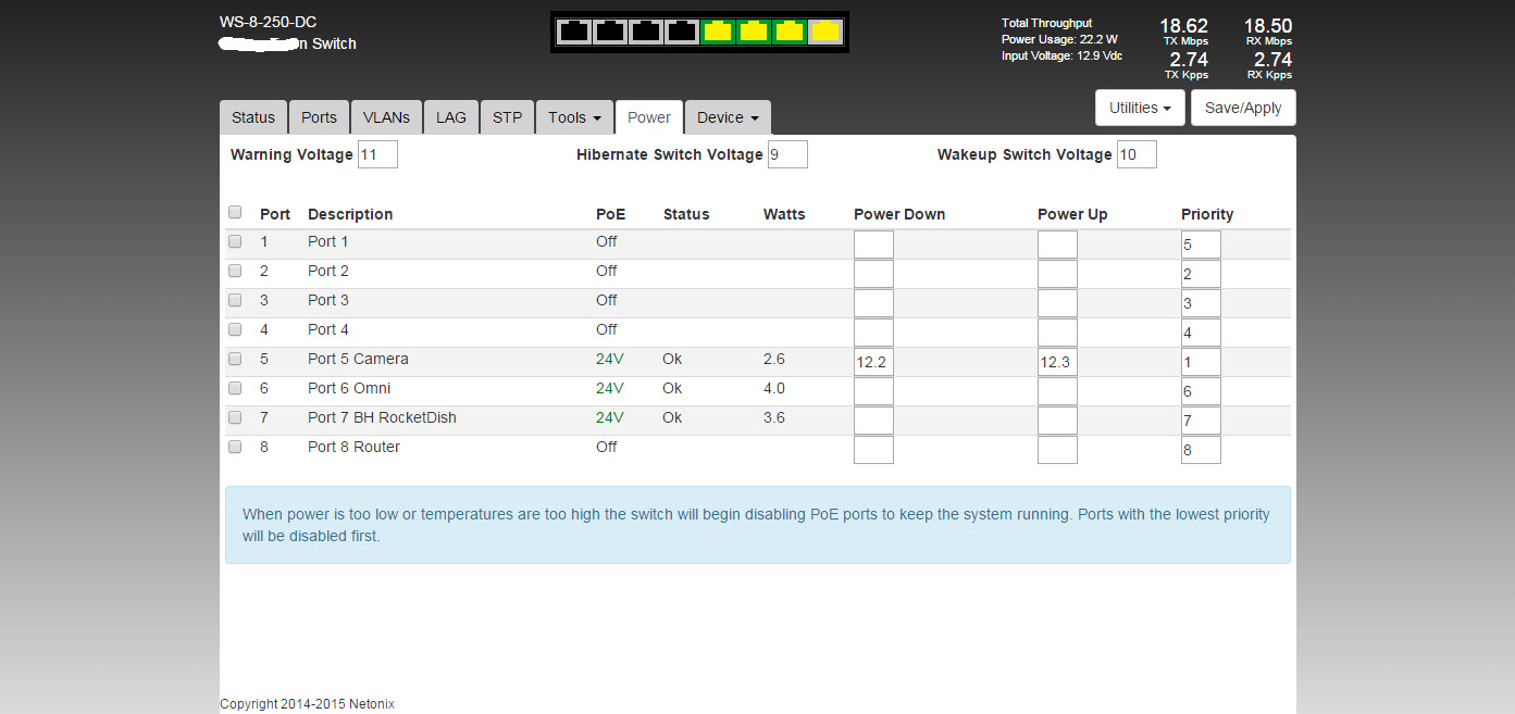

I've got two 8 port DC switches deployed and two 12 port DC switches deployed and until now I haven't had any issues.
Over the weekend I received three e-mails from one of our 8 port switches saying "Disabling PoE power on port 5 due to Power Supply Thermal out of specification (controller is 1610612736 C) - from JT Switch (10.247.28.5)". All three e-mail were received within 2 minutes.
right after I received this e-mail I logged into the switch and here are the temp readings from the status page:
Board Temp 41C /106F
CPU Temp55C /131F
PHY Temp57C /135F
Power Supply Board Temp35C /95F
Power Supply Heatsink #1 Temp28C /82F
Power Supply Heatsink #2 Temp28C /82F
Power Supply Controller Temp50C /122F
Our environmental monitor showed the box to be at 79f and our average power usage is 21w. Thoughts on this?

I forgot, port 5 is a camera and has PoE priority set to 1 so it would naturally be the first port to shutdown. The device was indeed powered off and recovered pretty quick. Below is the log.
