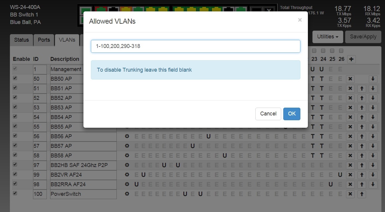

muammer wrote:but we need those vlans. because of the network security and we have to decide which vlan goes thru which port. With trunking option all vlans goes all ports.
We apologize for this issue, Eric will get this fixed soon but the VLAN Trunking allows you to specify a list (does not have to be all VLANs)
CLICK IMAGE TO VIEW FULL SIZE
