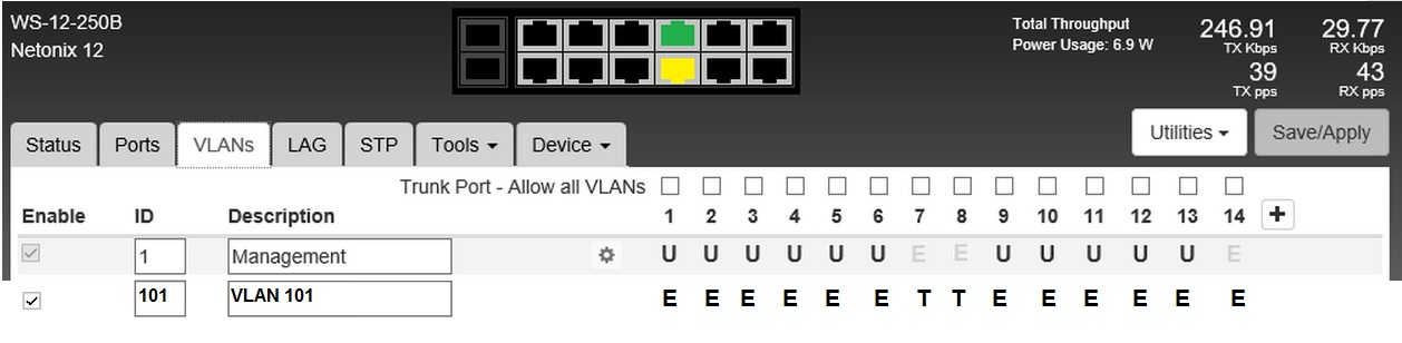

2.- Config very simple a PPPoE server on Port7 work on MikroTik over vlan 101 and a client (MikroTik) that open a PPPoE_cliente over vlan101, if i connect with a simple swith its work
3.- MTU is 1528
VLAN config
I need to made any change
3.- MTU is 1528
VLAN config

The way you have your switch configured will never work. you haven't configured VLAN 101 on any ports or enabled trunking.

I have try with this opstions
TRUNK --> NOT WORK
VLAN 101 --> NOT WORK
VLAN101 + TRUNK --> NOT WORK
TRUNK --> NOT WORK
Re: VLAN no working on WS-12-250B
So you want to pass VLAN 101 Traffic between ports 7 and 8?
The only VLAN you have configured is the default VLAN ID 1 and you have all "U"ntaged filters on the ports.
Ports 1-12 are all setup to accept "U"ntagged traffic.
Try creating a VLAN 101 and putting a "T"agged on ports 7 and 8.
This tell the switch that it will receive/accept packets that are Tagged with VLAN ID 101 in on port 7 or 8 and pass them through to port 7 or 8 and out and tho retain the VLANID Tag.
A "U" tell the switch that packets that come to it "U"ntagged will be accepted and packets without a VLAN "T"ag of whatever the VLAN ID is will be refused, dropped, or filtered however you want to look at it.
If you want to define the VLAN on the MT such as a sub-interface but have packets exit and enter port 8 without the VLAN ID Tag of 101 then put a U on port 8 on VLAN 101, this tells the switch that packets coming from the MT will have a VLAN Tag of 101 but when the switch pushes the packet out port 8 it will strip the VLAN tag off. Then when packets from a device in port 8 enter the switch without a VLAN Tag of 101 the switch will add the VLAN Tag of 101 before it pushes the packet out port 7 to the MT.

It sounds like his mikrotik or whatever PPPoE thing is expecting untagged traffic not tagged.
try untagging one or both ports in vlan 101.
post some screen shots of how the toughswitch is configured.
