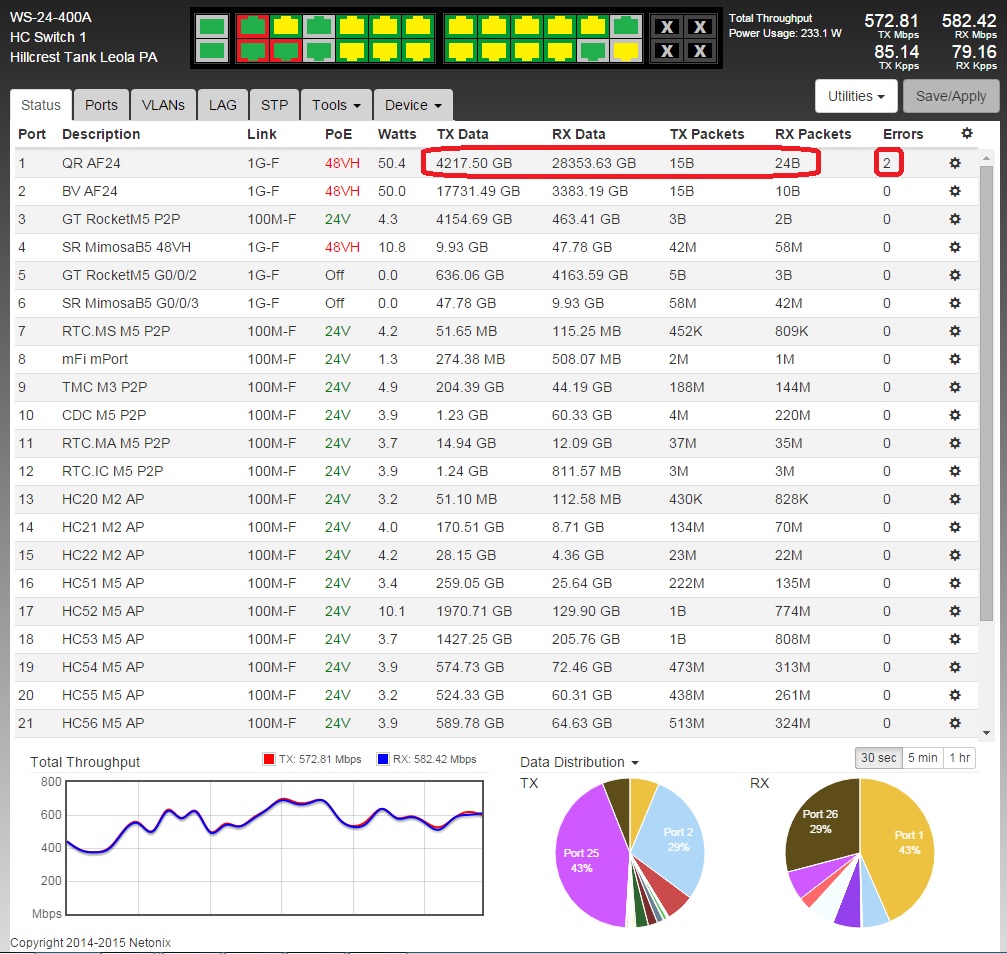

Well you can see below I have towers up for months with 2, TWO I SAY, errors in going on 2 months.
The switches are made in a cookie cutter style process (not in my garage or my bathtub) so they are all the same so why can I get them to work so well if there are SOOOOOO many issues with them?

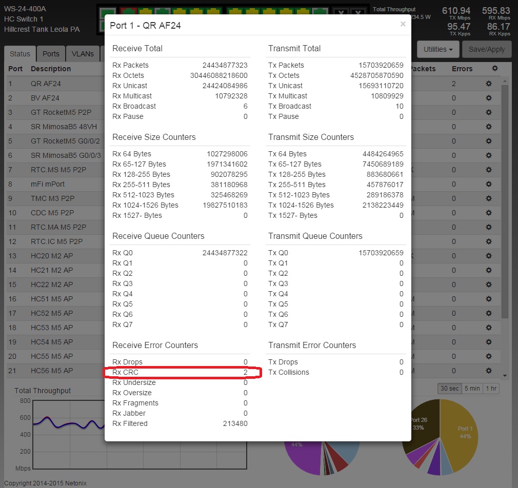

How do we know those 2 CRC errors shown below are my switches fault? They are Rx CRC Errors so it is more likely that the AF24 is at fault.
That is 2 CRC Errors out of 32+ Terabytes of data transfer.
2 OUT OF 39 BILLION PACKETS HAD AN ISSUE. - THATS AWESOME!!!
