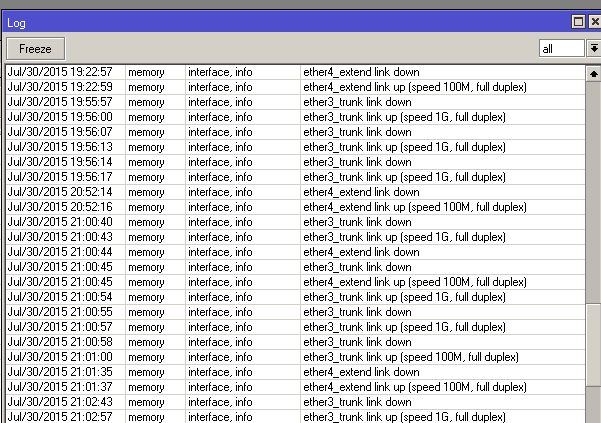

Re: WS-12-250-AC - Locking up?
This is what the log on the mikrotik router at the tower showed during the 'outage'. The Netonix on other ether3_trunk (ignore ether4 as it is another issue not related to Netonix).

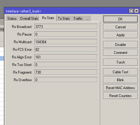

Here are the Interface stats. Normally there are no errors
