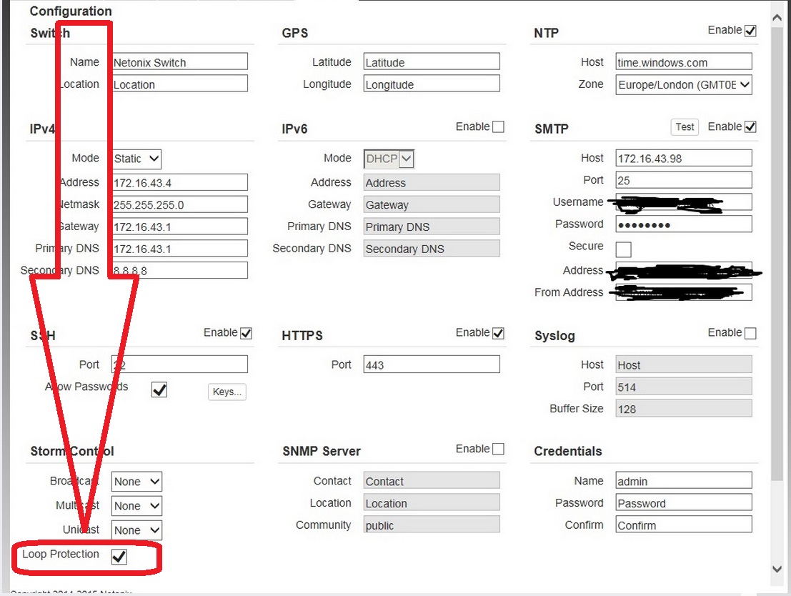

Where do I disable loop detection

But I digress, Device/Configuration Tab bottom left side of screen
