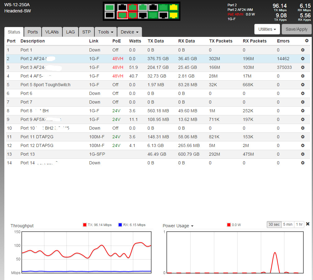

Here the history. I was running this ws-12-250A on 1.0.8 at our core for distribution. One day I noticed the wattage was way off. The switch showed both of the AF24's as only drawing 11watts and it showed the AF5 as drawing 9 watts. My rockets were showing as 2.4 watts. The total wattage was 56watts. This switch has 2-AF24, 1-AF5, 1-AF5X, 4-rocket M5s.
I figured a reboot was in order, but if I was scheduling downtime I wanted to upgrade. I upgraded to 1.2.2 and rebooted the switch several times (via software, and did a "reload cold"), but still the low wattage was being reported. So I drove to the head-end and preformed a power cycle. Now the switch is showing what I believe to be correct wattage on all of the ports except port2, an AF24. On port2 it reports 0 and occasionally .5watt.
Hardware, or software issue here?
erronious wattage reporting and then

I forgot. The errors on both AF24's are CRC and I cannot explain them. We've never had an issue with the cables and it seems odd to have it with both at the same time. Cable diag doesn't show anything on port3, but port2 show an abnormal termination on pair 2.
I have a spare ws-12-250a and I'm considering changing it out.

I switched the AF24 to port1 and the cable tests fine with both with our fluke and now with the WS. Any device I plug into port 2 shows abnormal on pair 2.
