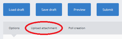

Upload screen grabs do not point to 3rd party host.
