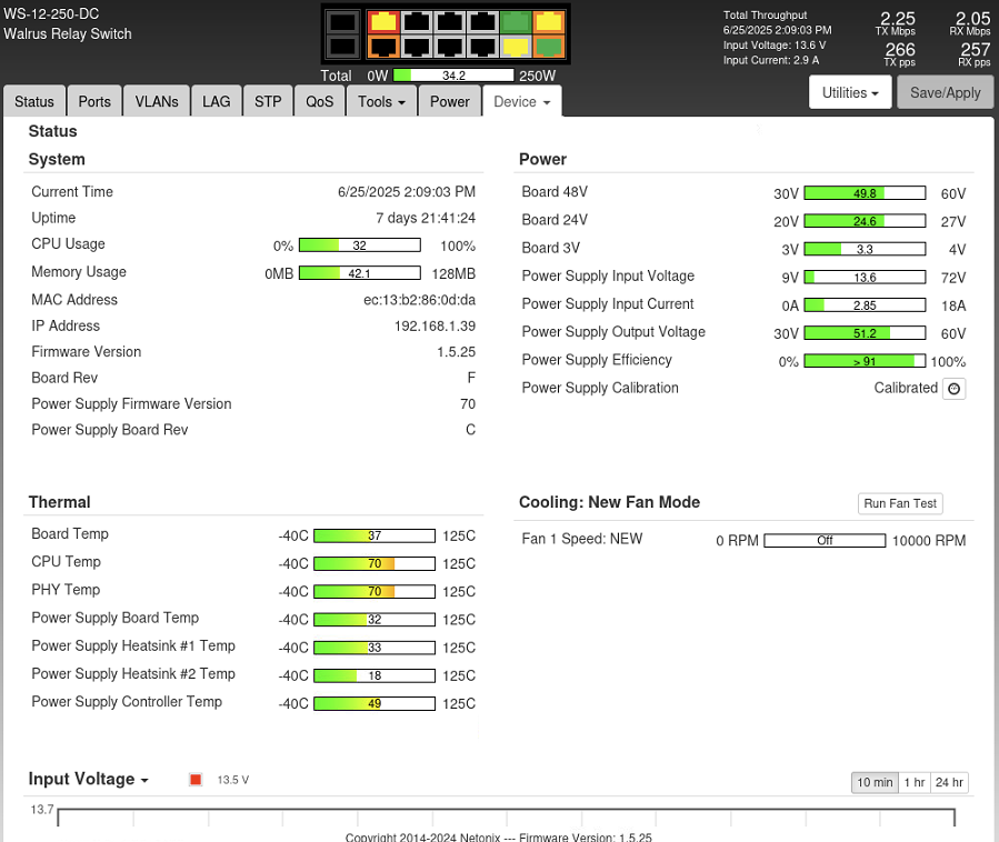

4.
Total power output is 37.0w (see attached screenshot)
Replacement switch screen shot
