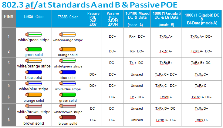

The ePMP 3000 series, including the 3000L, is polarity agnostic and can be powered with either standard PoE (4, 5, 7, 8) or alternative PoE (1, 2, 3, 6). The 3000L, in particular, requires 24V PoE and will not work with 48V. The ePMP 3000 AP (not the 3000L) uses 48V PoE.
Here's a more detailed breakdown:
ePMP 3000L:
Voltage: 24V.
Polarity: Agnostic (works with both standard and alternative PoE configurations).
Standard Pinout: + on 4/5, - on 7/8.
Important: Do not attempt to power with 48V.
ePMP 3000 AP:
Voltage: 48V.
Polarity: Standard pinout is expected.
Important Considerations:
Checking PoE Pinout: When connecting an ePMP 3000L, verify the PoE pinout of your switch and ensure it matches the 3000L's requirements.
Voltage Limits: The 3000L should not be powered by voltages higher than 30V.
Crossover Cables: If necessary, use a 5-pin to 7-pin cross-over cable adapter for compatibility with certain power supplies.

Okay, so, we're using how many 3kls and on what switch? Typically, we ask for a (redacted if necessary) screen capture of the device status page with support requests, saves a lot of this back and forth telephony.
With the heater running, the 3kls each pull ~15W.
the 24v supply in a 12-250 maxes at 6A for 144w. 135 if you count the fan/system draw against it (which we should), 12 3kls chatting full bore mid-winter is about 192w, well into ws-26-* territory.
Overdrawing the 24v supply would reboot the switch since that feeds the rest of the power rails, but hardware faults can cause them to underperform; I load test them to 120w and observe ripple with an oscilloscope here, you should see like 30-40mV p-p on a properly performing supply at that load
