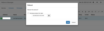

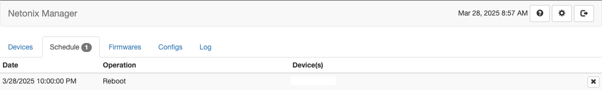

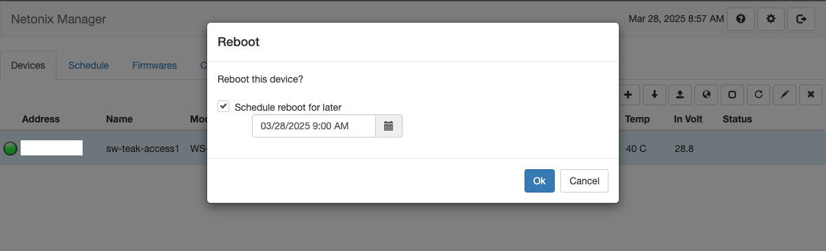

It appears as though there is a bug with the scheduling feature in Netonix Manager 1.0.24. Scheduled events are showing that they are scheduled for 13 hours after the time I've entered. I assume this is due to time zones, given we are NZT (presently GMT +13)? Though the Netonix Manager is showing my time correct, presumably because it's pulled that from my local machine.
Eg: Setting a time of 8am for the same day, the scheduled event shows 9pm the same day. See attached.
Setting scheduled reboot
Actual scheduled event

Ugh, this was a me issue. I'm running the manager in a Docker container and the container's timezone was set to UTC.... :crazy: duh
