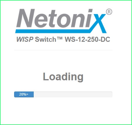

Hello everyone,
the problem occurred again after sixty days ...
This time I had the opportunity to be in front of the terminal and while I was trying to access the switch web console I saw this progress bar that I had never seen before ...
Is this a normal thing?

Re: Periodic reboot of WS-12-250-DC switches
And yes loading is now normal.
In older versions you simply could not access the web ui until it fully loaded. We thought this was better idea.
