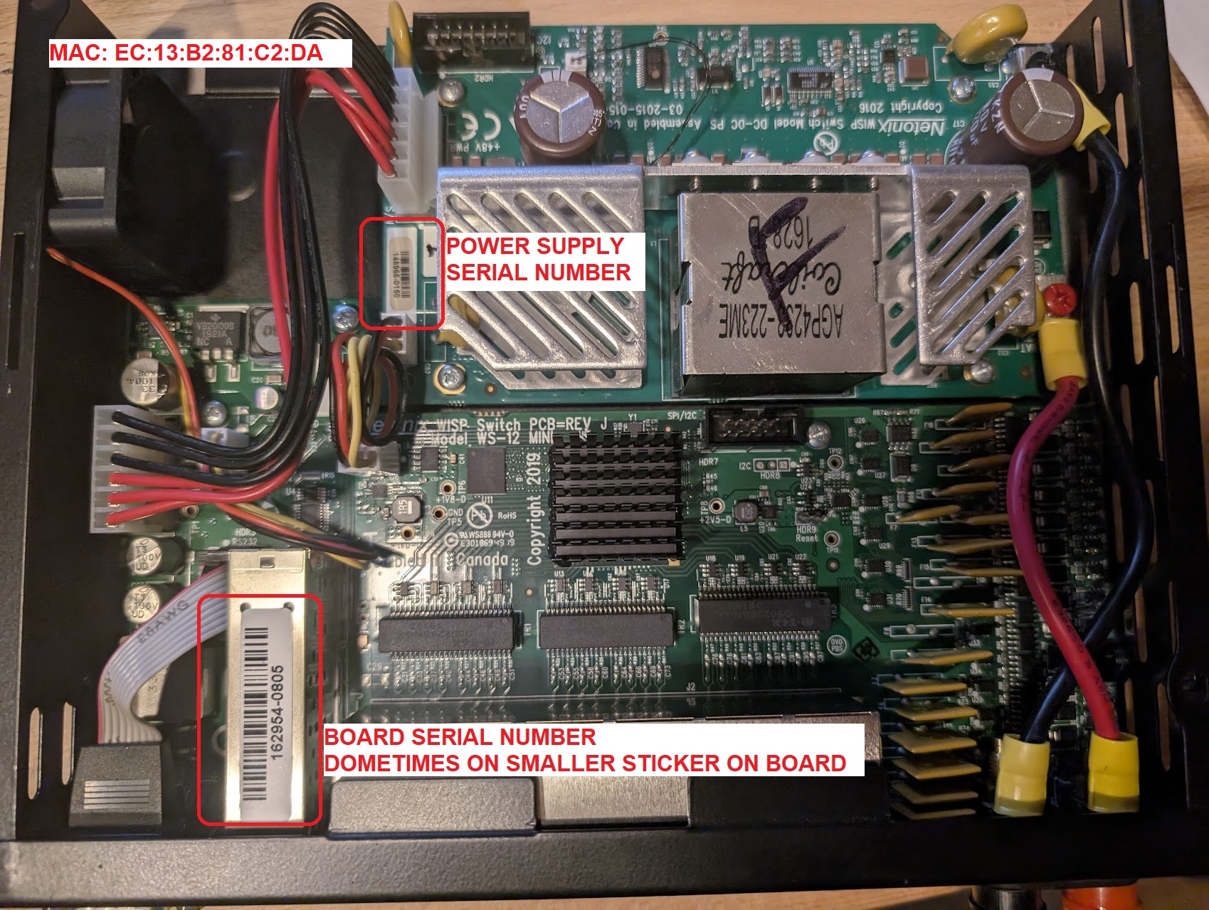

Re: WS-12-250-DC thinks it's an AC switch !!
Not sure what are the serial numbers...
See photos BELOW:
Thanks,
Yahel.
Notice I edited your post and uploaded the file to the post using the upload attachment link below blue submit button.
It is better to upload pictures as a year from now your link will go dead and this thread and conversation will be missing the needed pics most times making it useless.
Now if you got to RMA portal and punch in MAC: EC:13:B2:81:C2:DA you get info on switch:
Model: WS-12-250-DC
Mfg Date: 02/21/2017 (7 Years old)
Date Ordered: 05/13/2017
Order #: 145003327
Date Shipped: 05/17/2017
Shipment #: 100003309
Sold To: Streakwave Wireless
Now our records indicate:
Mfg Date: 2/21/2017
Model: WS-12-250-DC
Board Rev: F
Board Serial #: 148964-1383
Power Supply Serial #: 148966-0150
Location: Netonix
Tech Op: Eric
Destination: US
Firmware Version: 1.4.2
Picture info:
Power Supply Serial #: 148966-0150 <== MATCH
Board Serial #: 162954-0805 <== DOES NOT MATCH
I'm confused?
Did you buy a replacement board as I can not find this board assigned to any switch?
It is a NEWER board as Rev J originally that switch had a Rev F. Now it would have been serialized as F probably as the differences in Revs is discrete parts no firmware notification needed.
I can fix this, I just want to connect the dots.
Console into the switch:
You can use web UI console
Console cable
SSH with program like putty
once logged into the switch copy and paste the below into the console
Hit enter if needed to force reboot
Console cable
cmd
cat<<EOF>cfgfile
MAC=EC:13:B2:81:C2:DA
MODEL=WS-12-DC
BOARDREV=F
SERIAL=0
EOF
mtd write cfgfile config
reboot
That did it - seems fixed and no more identity crisis.
HOWEVER - there are still missing functionality - as it works as a DC switch without the smart PS - WS-12-DC not WS-12-250-DC !
Next - I will try to do the same but with the string "WS-12-250-DC" in the config...
I have no idea what happened.
I got this from our field-team with the complaint that it's it's thinking that it's an AC switch.
When you asked me to open and take photos of the inside, I realized that there is no warranty sticker!
So it must have been opened before?
But I'm fairly certain we never purchased a replacement board..
It's very possible this unit was sent back to you for repair, or something like that...
