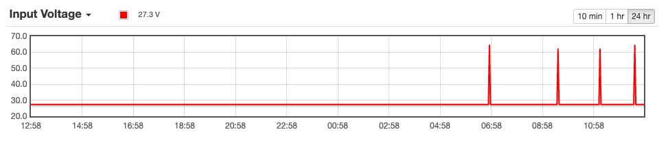

At the risk of not posting in the right place, we noticed a new issue that was introduced when upgrading from 1.5.14 to 1.5.16.
The issue is voltage graphs on DC switches (specifically WS-12-250-DC ).
The graph looks like that - essentially making it useless.
https://photos.app.goo.gl/bEkn2w9etwtHm5Ye7
We had to downgrade multiple switches back to 1.5.14 to avoid this issue.
I would love to know if this was reported/addressed in later firmwares.
To further clarify - these are NOT REAL surges - this is happening consistently on multiple switches (>40) and is not happening when downgrading to 1.5.14
Thanks,
Yahel.

Re: v1.5.21 Bug Reports and Comments
Try version 1.5.21
Not interested in bugs found in OLD versions.
Do you have ANY reason to believe this bug (which was introduced between 1.5.14 and 1.5.16) has been addressed later?
If there is any such chance, I would gladly try it out - but nothing of that sort in the release-notes that I could find.
Well we fixed a lot of stuff and it very stable.
Try it then report if not fixed.
Trust me it fixes a lot and is very stable.
If problem still there report and we'll fix.
Trust me bad issues including hackable and sfp issues and random boot loops and memory leaks all fixed.

yahel - Experienced Member
- Posts: 100
- Location: Berkeley, CA
- Has thanked: 22 times
- Been thanked: 22 times
Ok - I've upgraded two switches to 1.5.21 and sadly - I can report that the voltage surges from 1.5.16 remain !! (See my post above in this same thread).
(To clarify - these same switches do not have voltage surges in 1.5.14).
Please do a deep dive at what must have been introduced between 1.5.14 and 1.5.16 --- I'm guessing some I2C bus related code.
Thanks!!
Yahel.
Thanks!!
Yahel.
