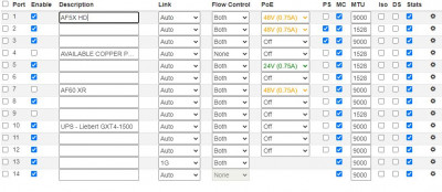

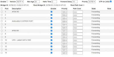

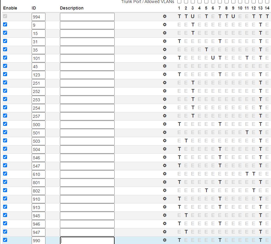

How do you have the port disabled. POE turned off or port disabled with POE on. I assume both ports are in the same VLAN?
Can you post up screen grabs of the following TABs: STATUS - VLAN - PORTS - RSTP
**** Remember to upload pics please use the Upload attachment link below the three BLUE buttons below this box on this page.

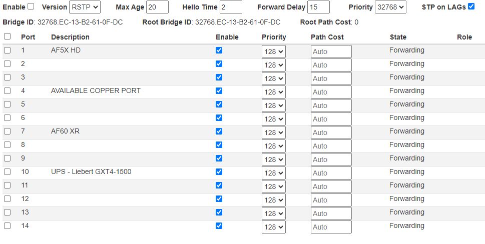

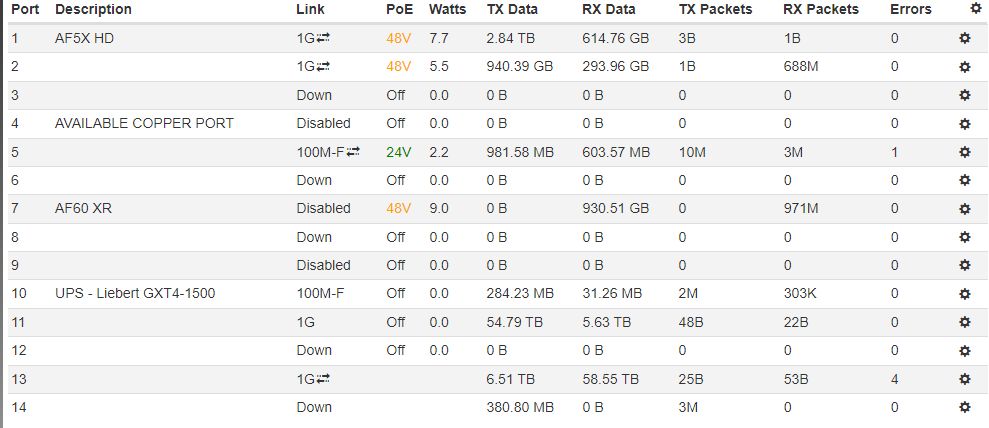

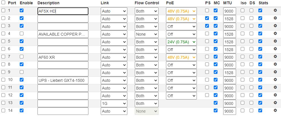

I have one of the ethernet ports shutdown but both are powered up.
In this case, Port 1 is the AF5X HD and port 7 is the AF60 XR.
Both ports are enabled on the far end, same settings. spanning-tree disabled and the same vlans allowed.
Enabling or disabling spanning-tree on both sides make no difference.
This used to work at some point but this was many firmware revisions ago.
Soon as I enable port 7 and disable port 1, all traffic is sent to the far end without any vlan tagging. I confirmed this on a packet capture. If I reboot the near side switch, everything is fine.
