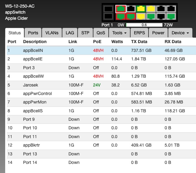

Running 1.5.14 . Watts shown on the ports where power is turned on are incorrect. I have one where shows 0 to 1 but the AP is working and should be using around 16. I have another port showing 147 and is the same hardware as the one above. A third is showing around 80 and same hardware attached. Another is showing 38 but is a small Ubiquiti ptp unit and shouldn't be anywhere near that.
Reboot did not fix the issue.
Any thoughts?
Terri
screenshot of main status tab

your switch has most likely been damaged...

blown current sensors. ignore it if you don't need current sensing on those ports, or drop me a line for out of warranty repair (this is definitely not a warranty issue)
