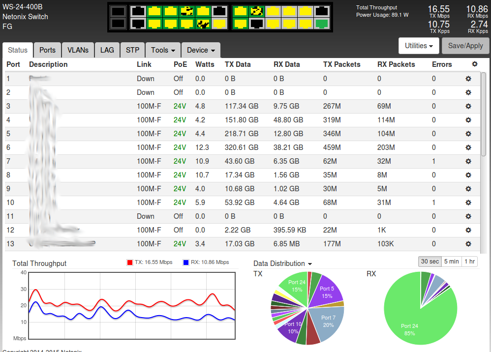

I'm attaching an overview of my particular switch. The devices in ports 3-6 have been there since last week Friday with no issues.

What's plugged in to the ports? Ubiquiti radios or something else?
Cable tests good? What was powering this stuff before the netonix?

Re: Random port drops
Yea, a little more info would help, why are you blocking the port descriptions which may help identify the device in those port?
What firmware version are you running?
I would examine the cabling and ends, like Adair said to cable diagnostics test from switch UI.
Tell us what is in each port and the cable diagnostic results.

Everything is the standard UBNT Rocket M5.
Ports 3 - 10 are our Sectors (I think 45 degree KP antennas).
Port 13 is a M2 running on a licensed frequency and 14 and 15 are rockets on dishes (backhauls to other sites).
Ports 17-22 are to a cluster of 6 Canopy APs (not powered by the netonix).
Port 24 is the uplink to our mikrotik router at the site.
It is running the latest stable firmware (1.2.2), as a side note is there any way to see what version it is running? As we look to roll out more of them we will need that to see which ones need upgrading.
They were previously powered by digital logger 24volt for the better part of 2 years, cable is shielded UBNT tough cable with shielded ends.

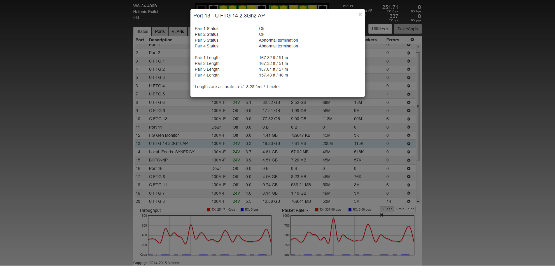

All the cables leading to UBNT devices are coming out with a cable diagnostics similar to what I have attached (the only difference is the cable length, which varies between 47 and 54 meters).
Well you can click on the Device/Status Tab and see the firmware version
Your cable diagnostic there shows abnormal termination on pair 3 and 4 and it should report Short and Short NOT TO BE CONFUSED WITH CROSS SHORT.
Pair 3 and 4 carry the DC power on standard airMAX 10/100 gear and it should report
Pair 1 OK
Pair 2 OK
Pair 3 Short (since the Blue and Blue/White are bonded)
Pair 4 Short (since the Brown and Brown/White are bonded)
Since you are showing abnormal termination I would "guess" one of the wires in each pair is not all the way up in the connector or the wire is damaged. If this is the case then the radio is only getting power on 1 wire for positive and 1 wire for negative which would cause the device to not be getting enough current so when the AP starts transmitting heavily it gets staved for power and reboots.
Also pair lengths should all be the same. When pair lengths are not reporting the same length it usually means the cable was stretch or kinked during installation and it is now JUNK! Ethernet surge protector will also mess the lengths up. Also always check the wire before you power up and after as some equipment mess with pair lengths until you power them up.
Another possibility is your using an Ethernet Surge protector WHICH I HATE and it is bad.

Doing the port swap seems to have stopped the random reboots:
9 <-> 19
10 <-> 20
The devices originally in 19 and 20 are not powered by the netonix (Canopy PTMP 100s, plugged into a last mile gear CTM).
This caused us to look at the other netonix device we have on our network and we are getting 3 oks and 1 short (screenshot attached). This site was brought up with a nextonix from day one (about a month or two ago) and we haven't seen any issues with it so far so wanted to see how it compared (all cables were tested with a fluke before the site went live).
In office testing with a unit whose deployment has been put on hold is showing abnormal terminations on ports 3 & 4 if we use a shielded jack into the netonix. Use a normal jack into the nextonix (continue with shielded into rocket) and it changes to just short on pairs 3 & 4.
We have a trip planned to the site with the reboots with the fluke on Monday to see which of the cables need to be re-run / re-terminated.

Just realized I forgot to mention the site in the screenshot has a cluster of 7 UBNT Rockets (should be 8) plugged into ports 1-7 and the trunk to the site's router is on port 24.
