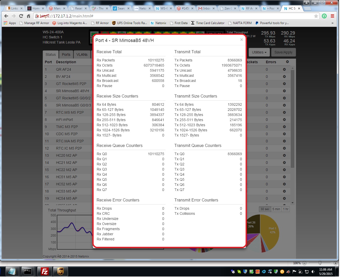

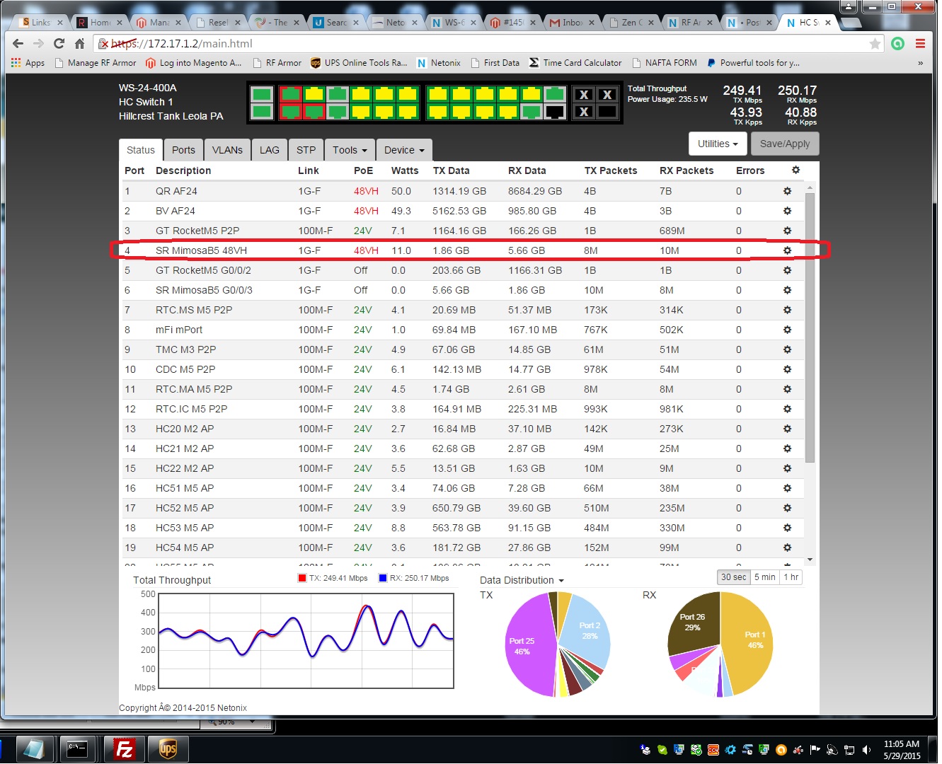

Below are screen grabs I "just" did - Note time on windows screen.
Now you might say my switch is a WS-24-400A and yours is a WS-8-250-AC but they are the same switch core, same parts, and same firmware just a different size.
CLICK IMAGES BELOW TO VIEW FULL SCREEN
