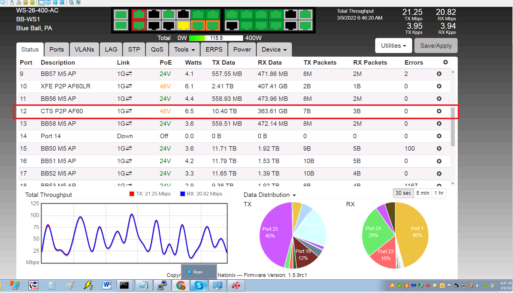

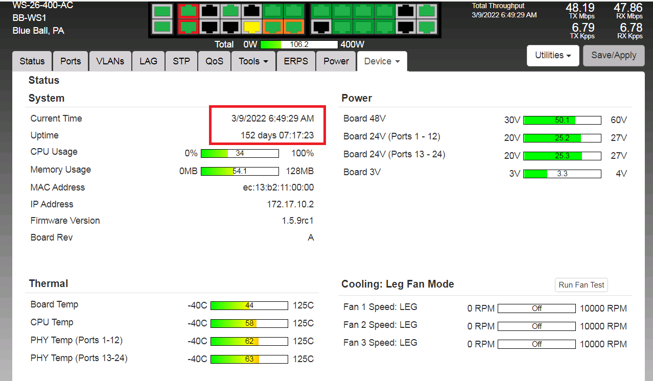

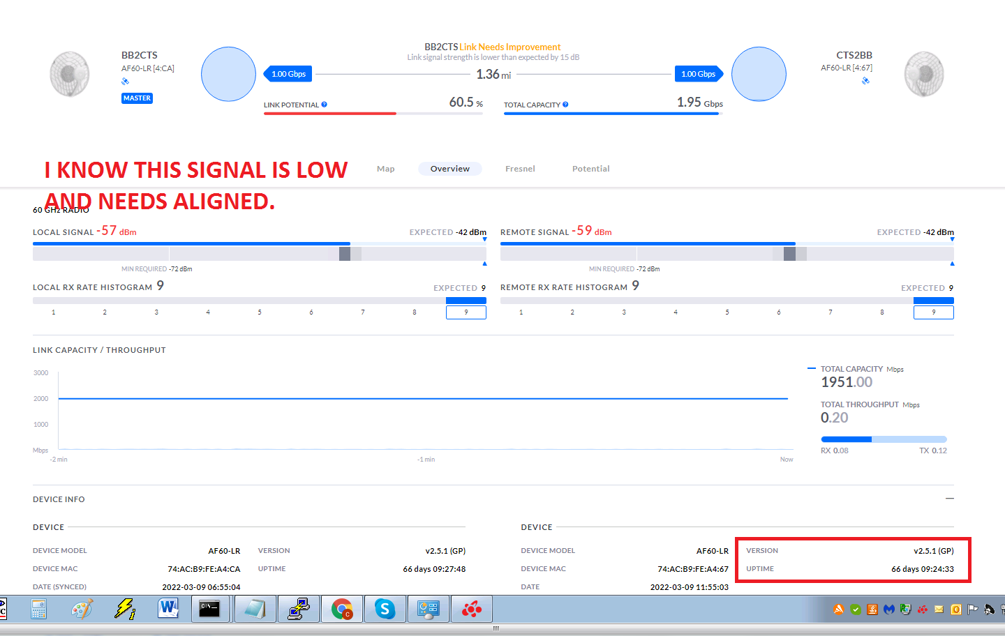

Re: AF60 LR MU lock ups
Wed Mar 09, 2022 8:02 am
I don't know what to tell you as I have many AF60LR in service all over my network with no issues.
This link happens to be the one to my house I can post more if you like.
Just realized another AF60LR is on port 10 as well in this picture below. We LOVE to use AF60LR for private high end PTP links for commercial customers and get $350 per month with $500 install for links 2 miles or less from tower and provide 350+ Mbps up and down.
Now keep in mind I have a routed network with VLANs to logical ports at each tower which you can see under Sirhc's Corner and a Post called This works well for me.
The only thing I can think of is if your running a large flat network and the AF60LR have issues with excessive broadcasts or something but that is not a Netonix issue.
I have several AF60LR up for about a year or more.
