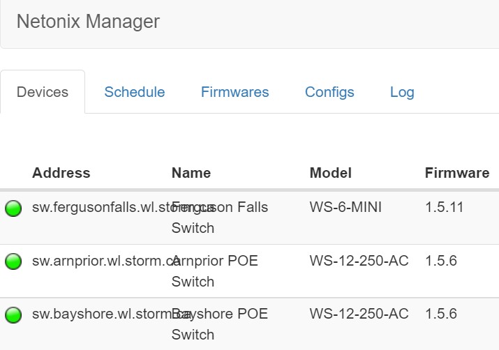

Is there a way to fix the overlap in the columns that I'm missing? It's rather annoying to not be able to read the address and name fields.

My Monitor is 4K and zoom level does not make a difference. The Address and Name columns overlap and are unreadable. It happens in Chrome, Edge and Firefox. It looks like if I zoom out to 30% then the fields are no longer overlapping, unfortunately the text is so tiny at that point that it's unreadable. Zooming in to 175% is when the overlapping starts to get worse and intrudes more. I've attached an example at 100%.

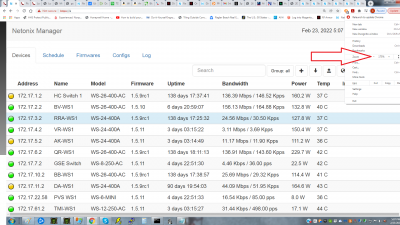

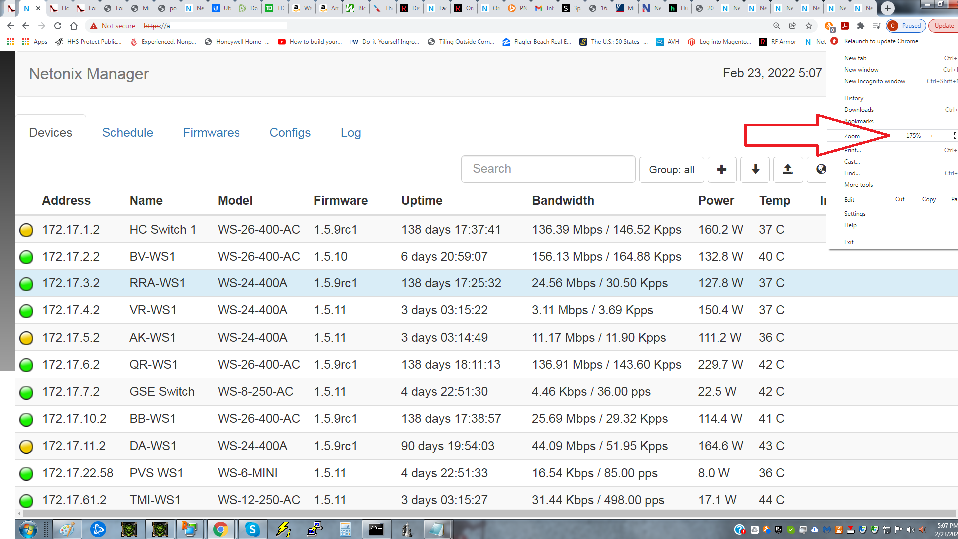

Not sure why you have an issue, I do not, see pivs below
In the 1 pic I made the switch name as long as the switch will accept at least with more reecent firmware as in some older firmware you could have a really nog switch name which we limited.
1st pic at 100% second pic at 175%

You're comparing apples to oranges. I'm following best practices and using the DNS Name in the address field. You're using IP addresses, what happens if you change yours to a DNS Name? I'm willing to bet you'd get the same overlap I'm seeing.

andreas wrote:You're comparing apples to oranges. I'm following best practices and using the DNS Name in the address field. You're using IP addresses, what happens if you change yours to a DNS Name? I'm willing to bet you'd get the same overlap I'm seeing.
You are correct.
I do have all my equipment in DNS so my rechs can get to it without the need to look it up
example HC2BV.netlinx.net which resolves to the AF24 on Hillcrest side of the link between Hillcrest to Bareville but I put the IP in the manager.
Also if I need to restore all my equipment within my network not on valid IPs I can simply tell the manager or aircontrol to search 172.17.X.X and it finds them. And then those that are on valid IPs I search my routable ranges and find them.
But I do use DNS so techs can find devices based on a name
