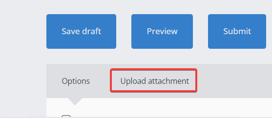

Re: PoE Ports
Sun Jan 30, 2022 10:51 pm
Use the "Upload attachment" link just underneath the "Submit" button to attach pictures.
