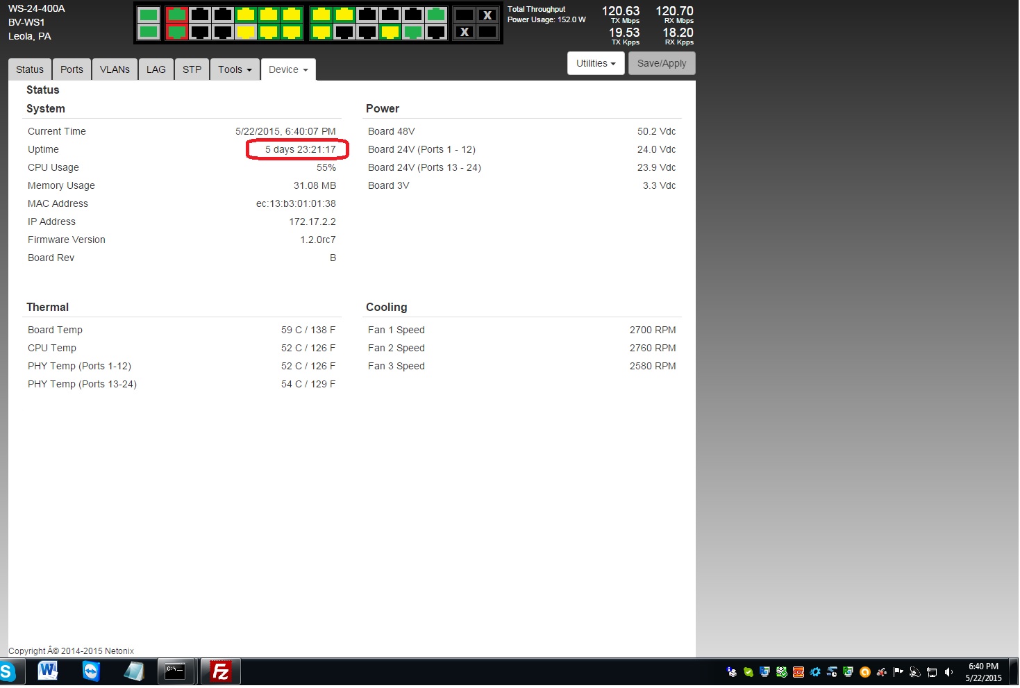

Last weekend we had a BAD thunderstorm roll through where my WISP is located in Lancaster PA and a Tower (Bareville Water Tower) went down in the storm.
Thinking the worst I drove out expecting to see some carnage but all we had to do was reboot the switch, no damage was done but obviously the thunderstorm did something the switch did not like.
The switch is still in service running great. See picture below of that switch which we rebooted 5 days ago (last weekend).

Yea I know I need to upgrade the firmware, but this is a low priority tower and I forgot about it and as you can see this is an OLD RevB board (we a re now on RevD on production units).
